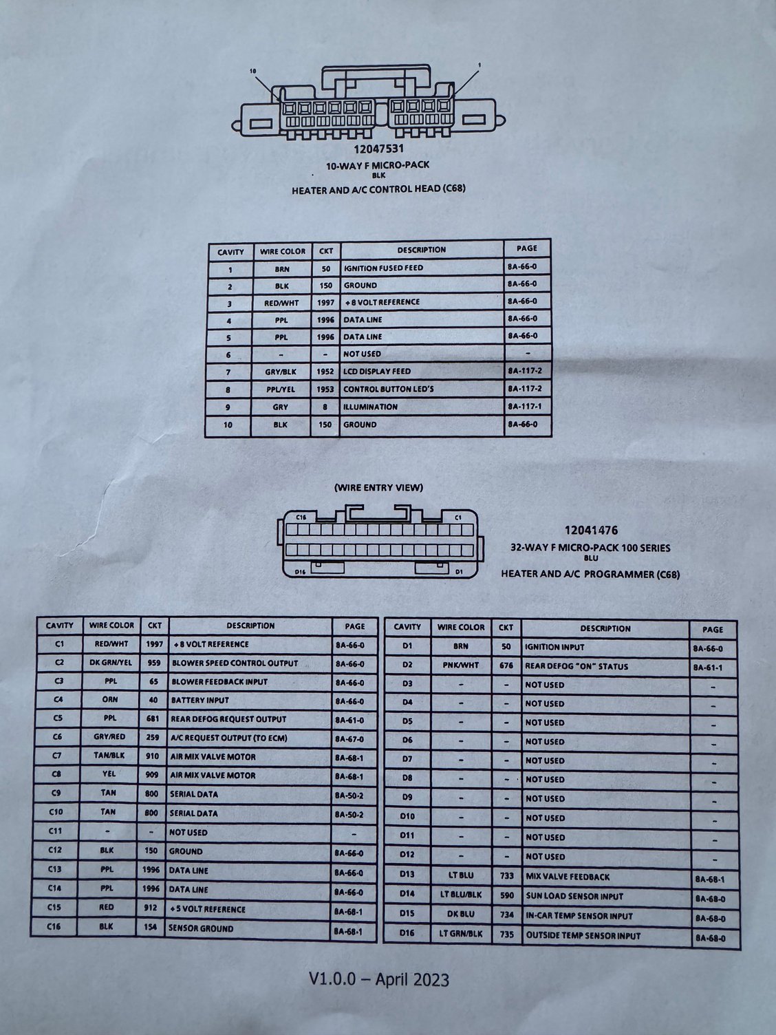

This is a pin out chart for the 1990-1996 HVAC Programmer.  You may notice on your car year’s wire harness the colors don’t match up to this chart’s colors.  Its best to use the Electrical Supplement section of the Field Service Manual (FSM) for your car’s exact model year to get your colors to match.  But I think you will find the wire description / function to be the same as this chart.

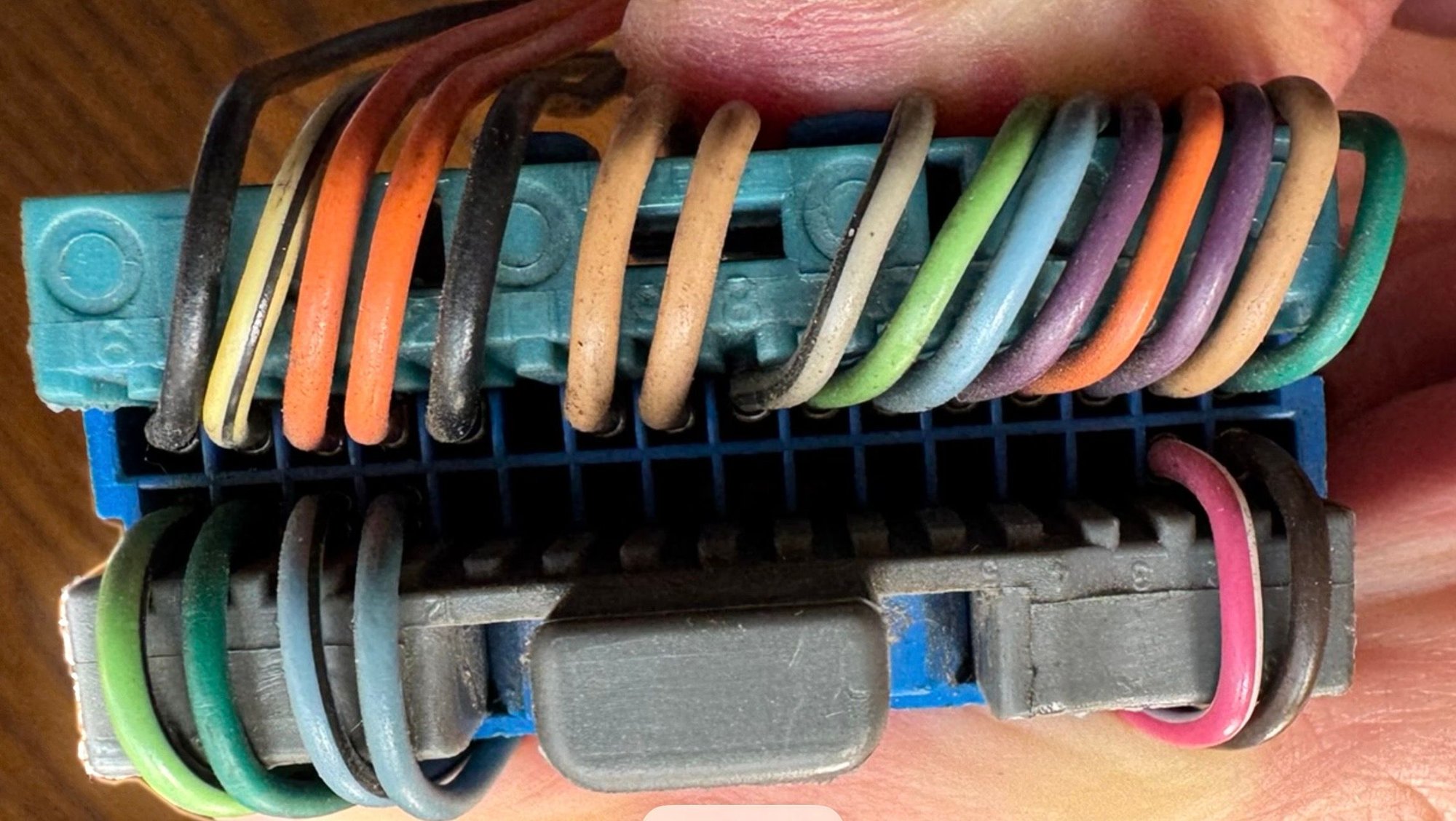

This is the wiring harness from a 1993 Vette. The D1-D16 wire colors mostly match the chart but not 100% (D15 is dark green on the harness and noted at dark blue on the chart).  But the ports used for wires and ports that are empty match up perfectly.  Use the FSM Electrical Supplement for your car’s model exact model to year to get a model year specific chart.  FSMs can be bought and download from multiple online marketplaces.  Just make sure you get the electrical supplement with it.
