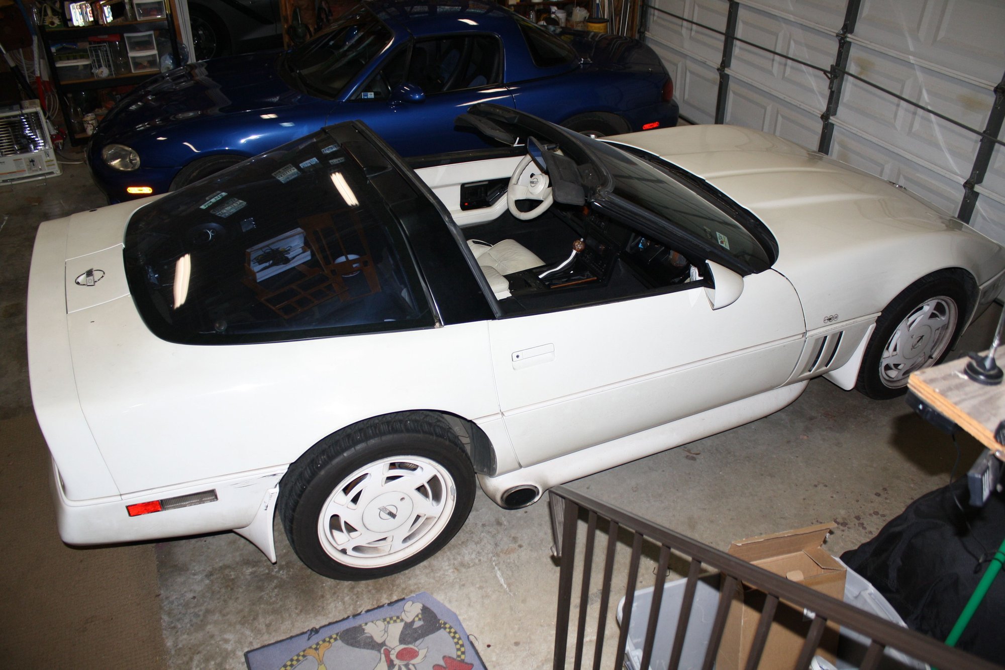

Just snagged a pretty decent 1990 L98 convertible and it is a dog! It seems to run ok with no missing or weird noises but is a turtle compared to my LT1 car.
Normal?

Originally Posted by bassackwards
the car in the picture looks to be a 91 or newer. the 90's had the old style black beltline, different front and rear bumpers. looks to be a pretty decent looking vert. my old 89 6-speed coupe used to run mid 12's with a pretty much stock motor, didn't even have headers. a die grinder on the intake system and exhaust manifolds and a few other mod, it would smoke a stock lt1.

The car is a 90 with newer bumpers. I'm sure it has a 2.59 as does my 92.
My 92 will try to go sideways when it hits 2nd. This car has nowhere near the oomph.
It doesn't have any knocks or misses or rich exhaust or anything obvious that would be killing power. I will tinker with it including timing etc to make sure all is right.
