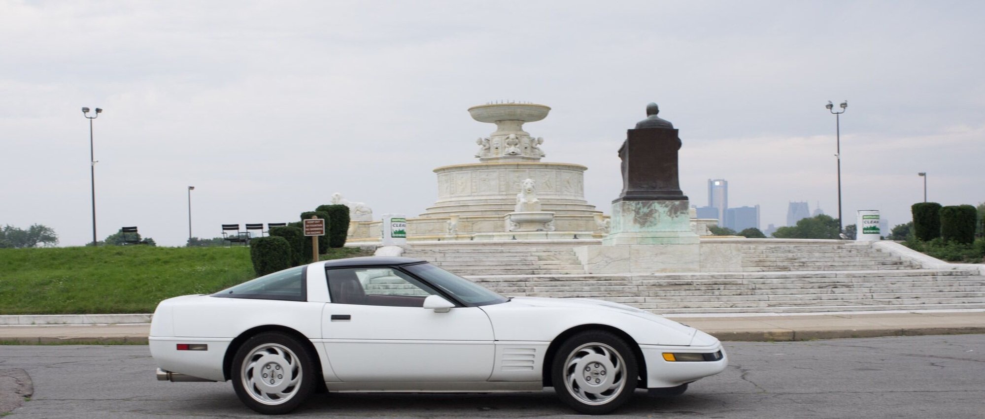

Old Jul 25, 2015 | 12:24 AM
ballhog's Avatar
ballhog
Joined: Jun 2009
Posts: 27
From: Romeo mi
On a good day
Old Jul 25, 2015 | 12:46 AM
Hooked on Vettes's Avatar
Hooked on Vettes
Joined: Aug 1999
Posts: 2,240
Likes: 42
From: Baltimore, MD USA
Belle Isle with the Renaissance Center in the background.
Sad to see the Motor City with so many burned out, crumbling and abandoned houses and buildings.
