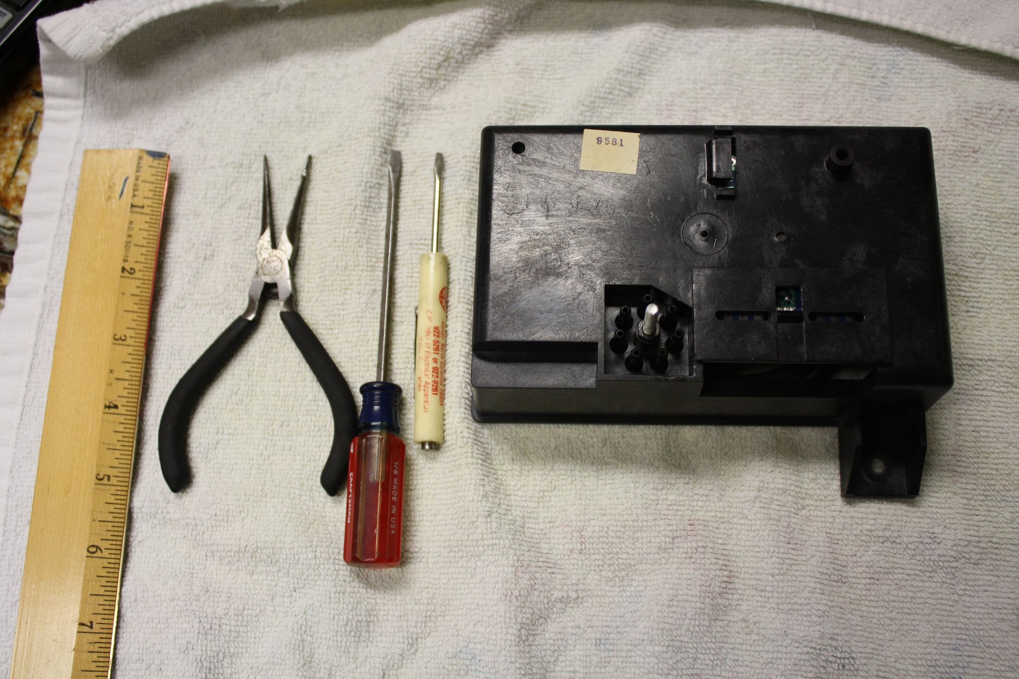

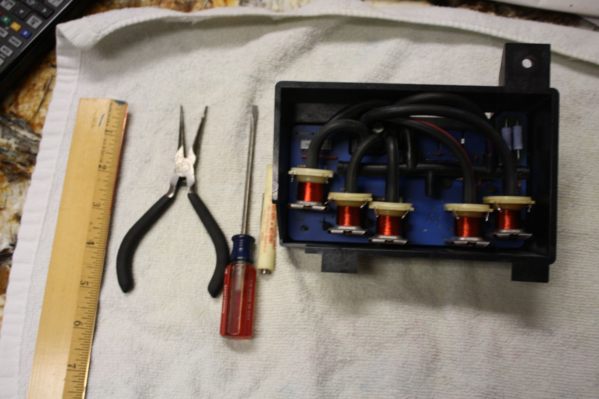

This photo shows the air blend door. This unit is a heater core removed from a 87. To see this door you have to find the blower control switch ( I don't have a pic) located on the passenger side on top of that big plastic housing. There are 3 - 7mm screws and 2 wiring harness plugs attached. remove both harnesses and the 3 screws and a big sensor will come out of a hole in which, with help from a light, you will see this door. See if it swings freely, a long screw driver or breaker bar will do. If the door does not move then your problem is the Programmer.
This is the programmer.
AC Programmer facing the driver
AC Programmer facing the firewall
