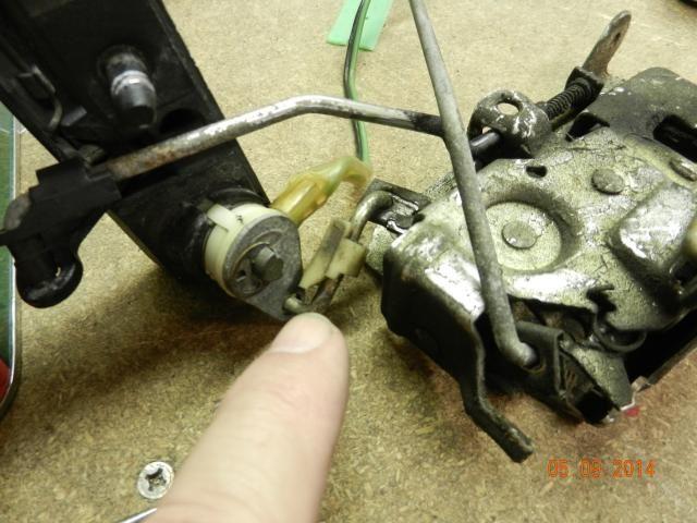

Originally Posted by WVZR-1
Rod to the door latch has fallen off because of retainer failure or the pawl has failed.
- here's a pic - the most likely culprit is the retainer
age takes it's toll on these plastic or nylon parts. not a hard fix - a fair amount of work and a bit of a PITA. i had the same repair on my 85. some part number info...
Corvette Central #: 454010
Original GM #: 20007898
