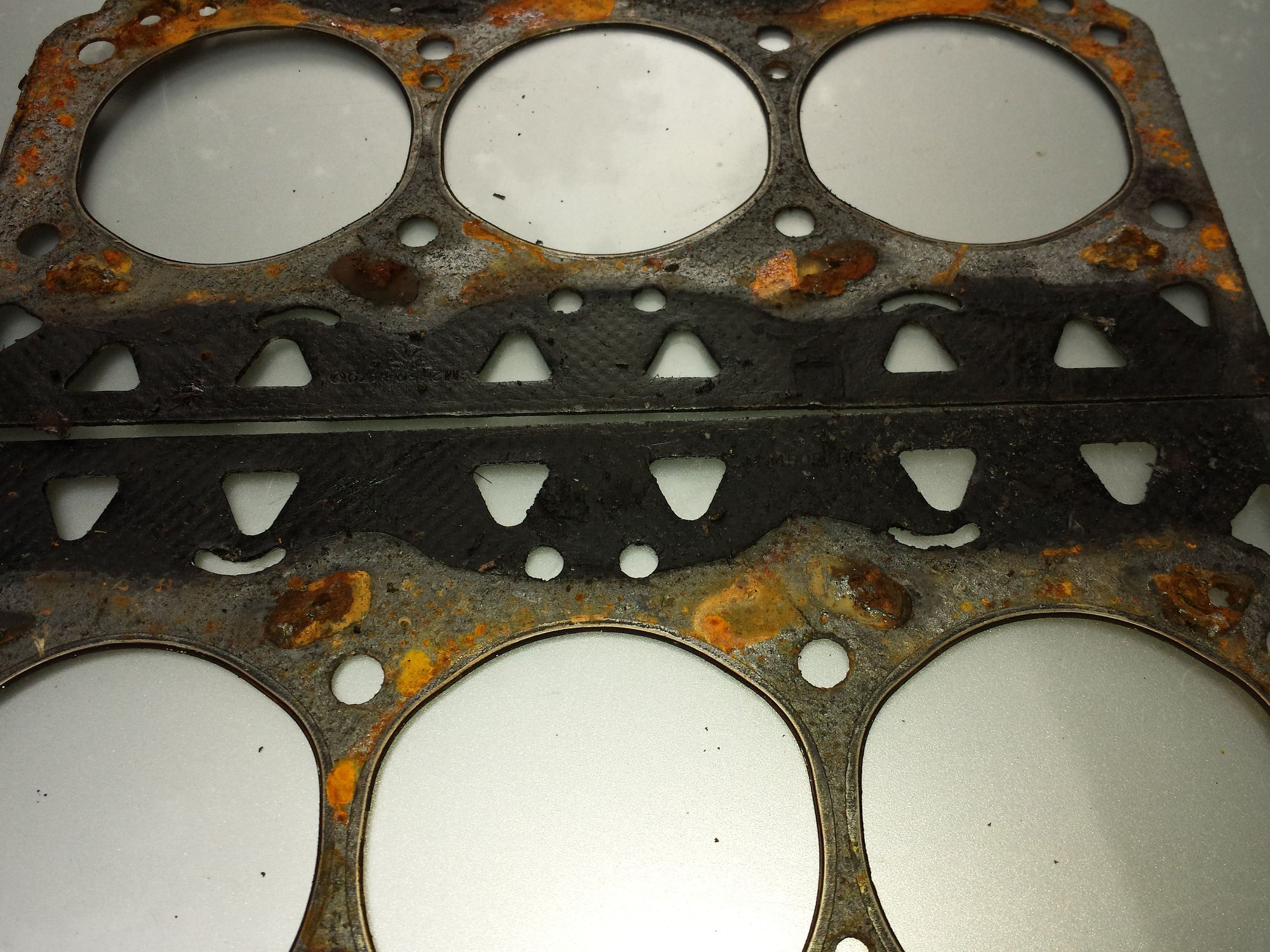

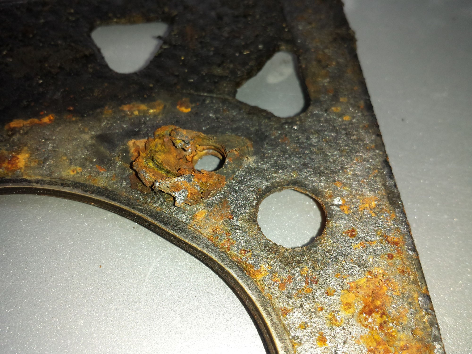

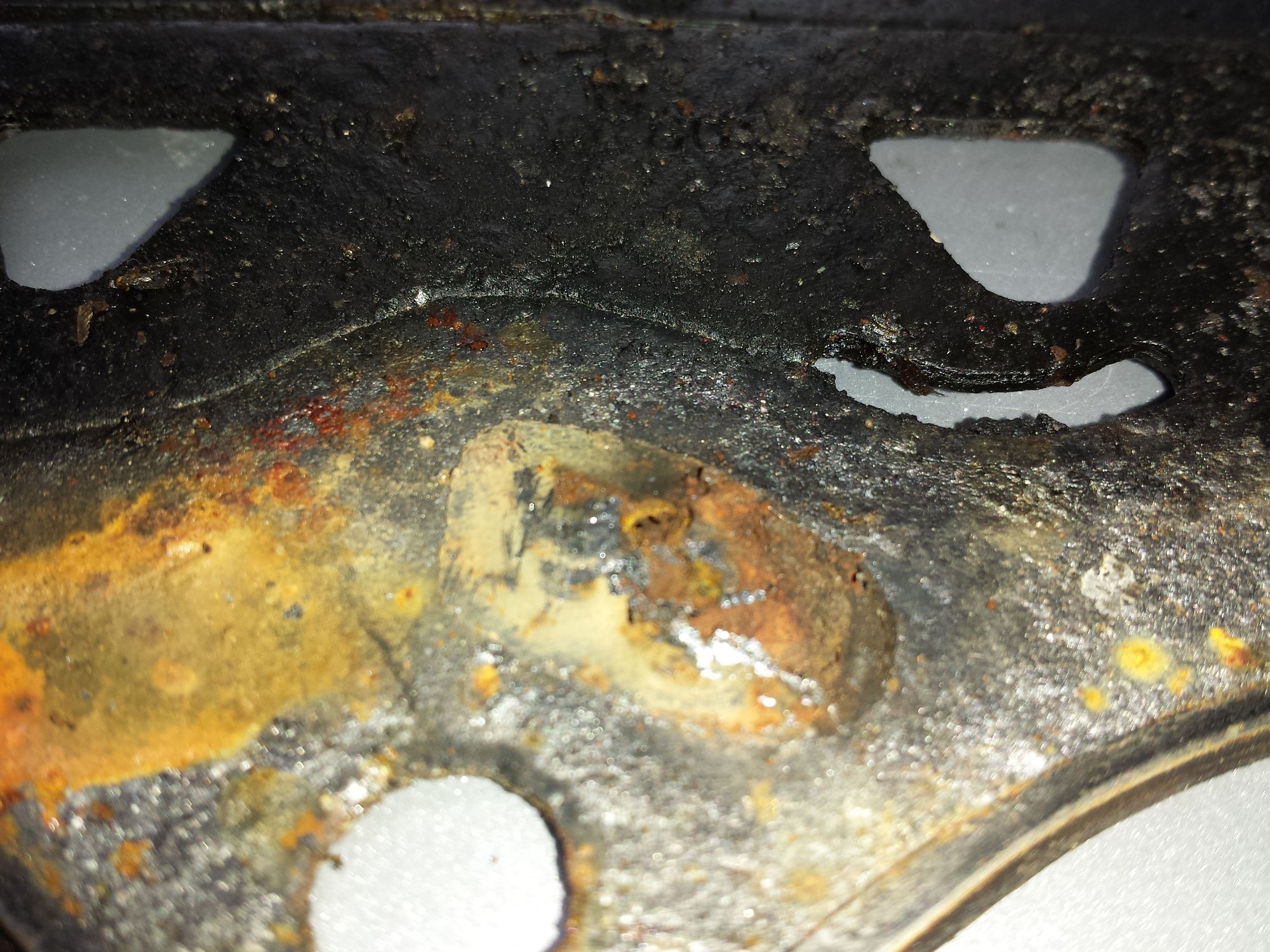

Pics of my SSEi head gaskets removed about 2 weeks ago 110k some sludge buildup in multi spots. The coolant itself looked very healthy. The White powder I did save aside. And lost due to rain. While I was in there did some porting to Exhaust ports on the heads, 1 Iron manifold, the other is tubular. Also ported the supercharger, TB, & intake. Two 8mm exhaust bolts broke very difficult to access on the firewall. I was way more concerned about getting my daily driver back together. Then to prove or validate myself. to anyone that refuses to believe the fact Dex-cool does have problems with some engine combo's.. GM did in fact get sued. Tom your typical child like responses you consistently post are retarded from someone that knows enough about cars. I really Do not care if you believe anyone. because Tom say's it cannot happen!!!!! I do not need to prove or ask Tom for permission. I wish I placed the Actual white powder scraped off of various parts in a baggie. Luckily there was no real damage this powder did etch/corrode very minimal into a few parts including the upper radiator hose. The gaskets are now rusty from sitting outside.
digging into a few more GM lawsuits sources.
they claim the wet intake systems are the one's that suffered this problem. Taking out gaskets. Creating air in the system & so on. Pretty interesting the LT1 started the dry intake.
You don't "get it", what proof is. Anyone can sue for anything. That someone brought a suit against GM isn't proof of anything! It is evidence. Evidence of what? That there was some kind of problem. Was it the coolant? The gaskets? Other materials? We don't know, and the fact that a suit was brought, no more "proves" Dex Cool is the root problem, than if I were to bring a suit agains you, then tout it here on the forums as "proof" that you're what ever I'm claiming in my suit. Get it? Yes there were problems. Coolant related? WE DON'T KNOW, and a suit "proves" nothing.
I'm the one who's childish and "retarded" here? Have SEEN what you post? Here is childish:
Nasty Dex devastating fluid
write us up your epic BS 10,000 page hypothesis
major destructive corrosion
most vette owners are obsessively meticulous
As for "retarded"...have your READ your posts? Punctuation? Sentence structure? I think you calling my posts "retarded" is the pot calling the kettle, black. Learn how to type, and put a paragraph together that makes some sense, before you start calling others "retards".
Now hold on a second....TOM never said that. What Tom ACTUALLY said, was that Tom has managed a fleet w/100's of 1000's of hours of trouble free Dex use, then Tom posted real world results of PROPER, Dex cool use. Then Tom asked, where the "white powder" was? If Dex cool does the things you said, shouldn't there be evidence of that in a 243,000 mile vehicle?
I absolutely believe that things can happen; "white powder", sludge, and other issues. WHY are they happening? We don't know. Could be Dex, could be the water used, could be other contamination, could be poor PM....tons of things. Just b/c there is a "new/different" coolant in there, that isn't proof that is the cause, and spouting off about it makes it no more so that way. It just spreads misinformation. Additionally, when I post pics of 200k+ mile radiators that look virtually brand new (with proper Dex use), how can one rationalize that it causes hell in one engine, but not in another similar engine? How does that make any sense?
I'd guess that the "white powder" is the result of what ever you had going on in there, not the cause. I totally believe you that you saw something in that motor. Never said otherwise. I don't believe that what you saw was caused by the coolant. I think it's an engine-specific problem.
