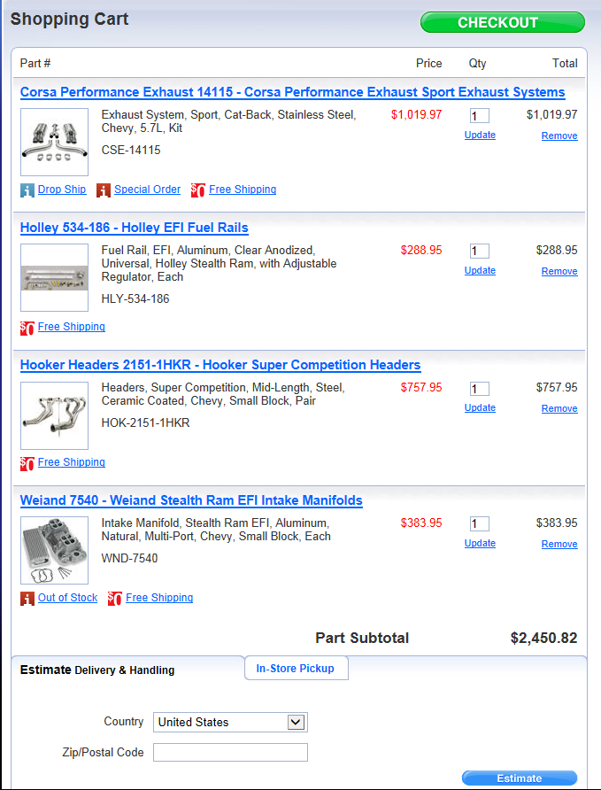

Hi guys. I'm ready to click the button on a purchase and I wanting to get some assurance before I purchase. I have a bone stock 87 corvette and I'm wanting to buy a new exhaust and intake. I have a hood too. Are these parts going to fit? Do I need the fuel rails? What intake gaskets will I need? Is there anything I'm missing? Please let me know, thank you

The stock fuel rails won't work with the stealth ram and neither will the hood from what I've read.

affirmative. The HSR will not fit under the hood. unless you mill OR angle mill the top of the HSR
or cut / mod your hood almost 2'' from the TB back. also the Holley fuel rail kit is way to much money$$$ but is a direct bolt-on. You can purchase FAST rails with AN fittings for less.

I am also getting the toledo pro hood which from what I read will work. What about gaskets does anyone recommend a good gasket and header bolts or should I just reuse the stock bolts?

Stage 8 header bolts. Fel-Pro or similar.
