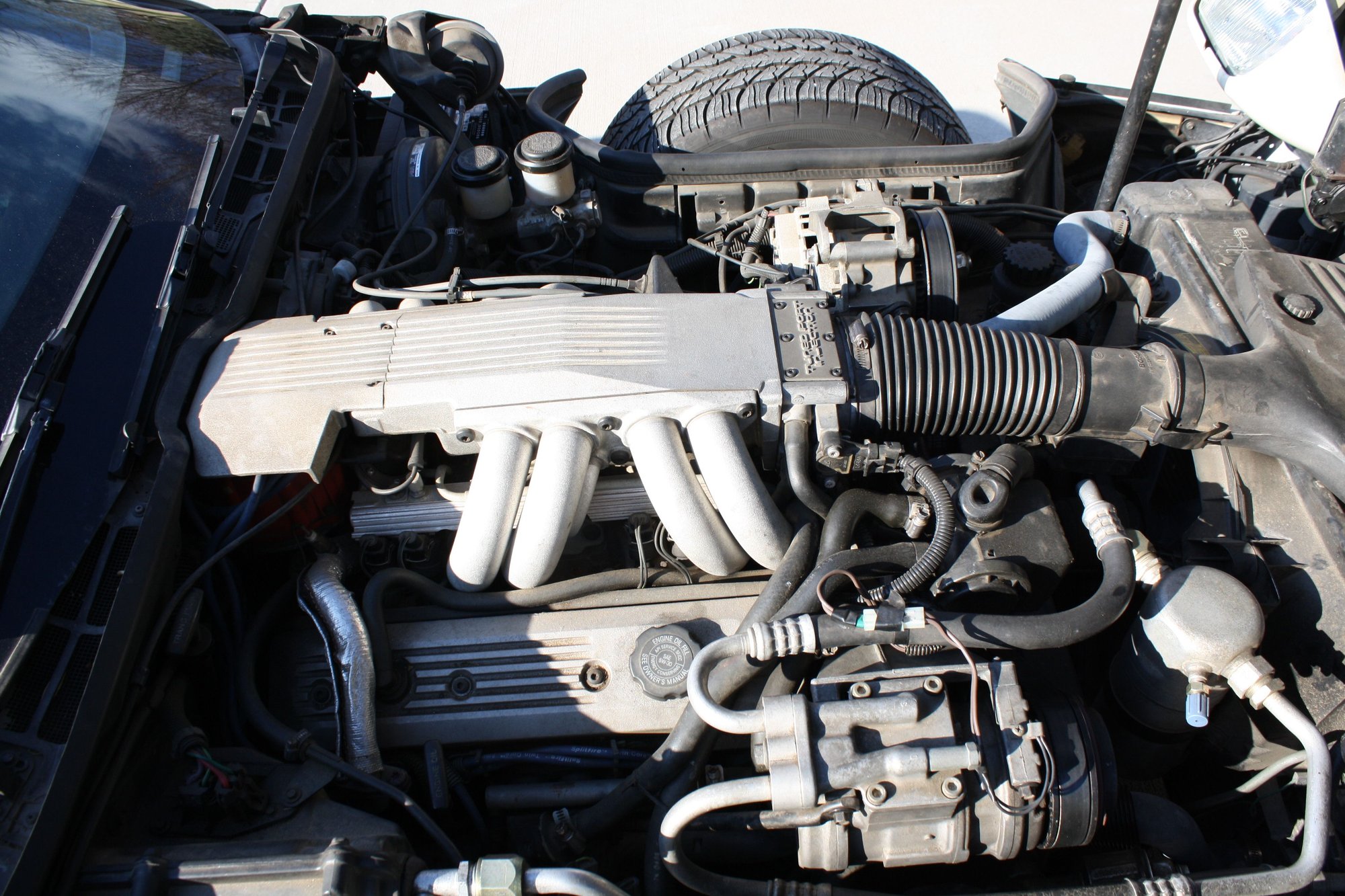

Not a great pic on my 88 L98. You will see a small black metal pipe that runs from the coolant/heater hose that connects to the back 2 cylinders, 7 & 8. I am sure there is some coolant value on the back of the intake but it has to be minimal.
