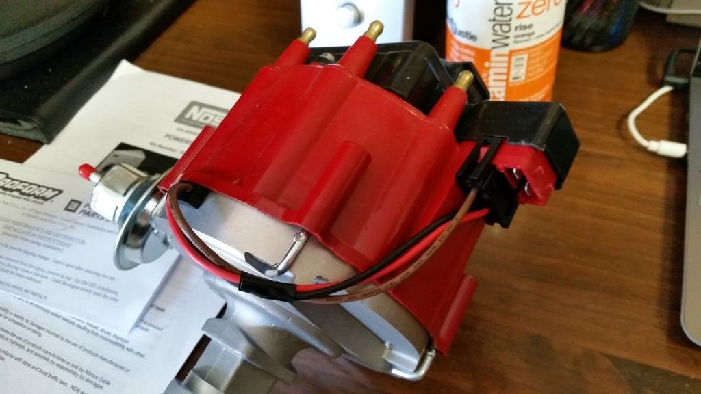

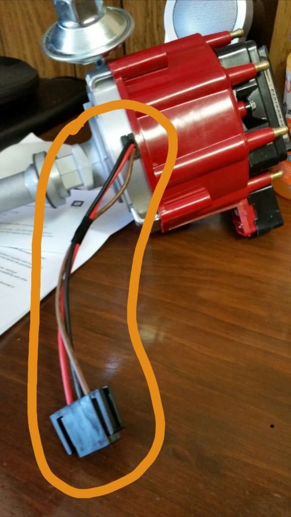

I swapped my 84 corvette to carb and i got this new proform gm performance HEI vacuum advance distributor. At the base of the distributor there are 3 wires to a black connector. Does this connector circled in orange the picture plug into the the top of the distributor cap as shown in the other picture?

nope

So is there a harness i need for this and what are these 3 wires, not using the stock wiring harness so i need to know what the purpose of the brown, black and red wire so i can wire them to the appropriate places.

do you have a FSM? I have never done this but sure someone will be along soon. Sorry took a second look I thought you were going for the other spot.

That 3-wire connector is to the pick-up module and I'd say you've got it appropriately connected in the 2D snapshot. I see no reason to doubt that. I would think there was an instruction set with the purchase that would explain. So long as you're doing "coil in cap" HEI I'd say it's fine.
I would think the connector is actually "indexed" to prevent wrong insertion.

Yes that plugs in there, all you need now is a 12v source to make it work. The heavy red wire is the 12v source, the unused one is for the tach.
