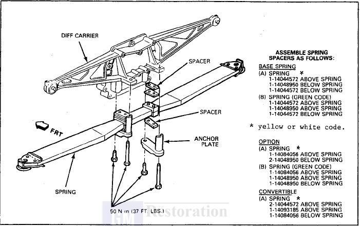

Old Sep 20, 2015 | 10:21 AM

Originally Posted by jv9999
The insulator in question isn't included in your image. Only the variable thickness is mentioned because the insulator is a fixed dimension and there's no alternatives.

I always thought the insulator is the rubber piece molded around the spring. It has the two extrusions on both sides that hold the spacers in place. That is shown in the diagram.
If there's something not in that diagram, my car doesn't have them.

Regarding the above picture, my service manual shows a very similar picture but also includes a drawing of the insulator positioned just above the spacers.
#7 in this image:
http://www.wholesalegmpartsonline.co...riveLine=11463

Originally Posted by WVZR-1
I think that's just the very thin shim. The one that's the thickness of the extrusions on the other ones. It lets it move a little on the top part of the mount. Maybe they call it an isolator.
