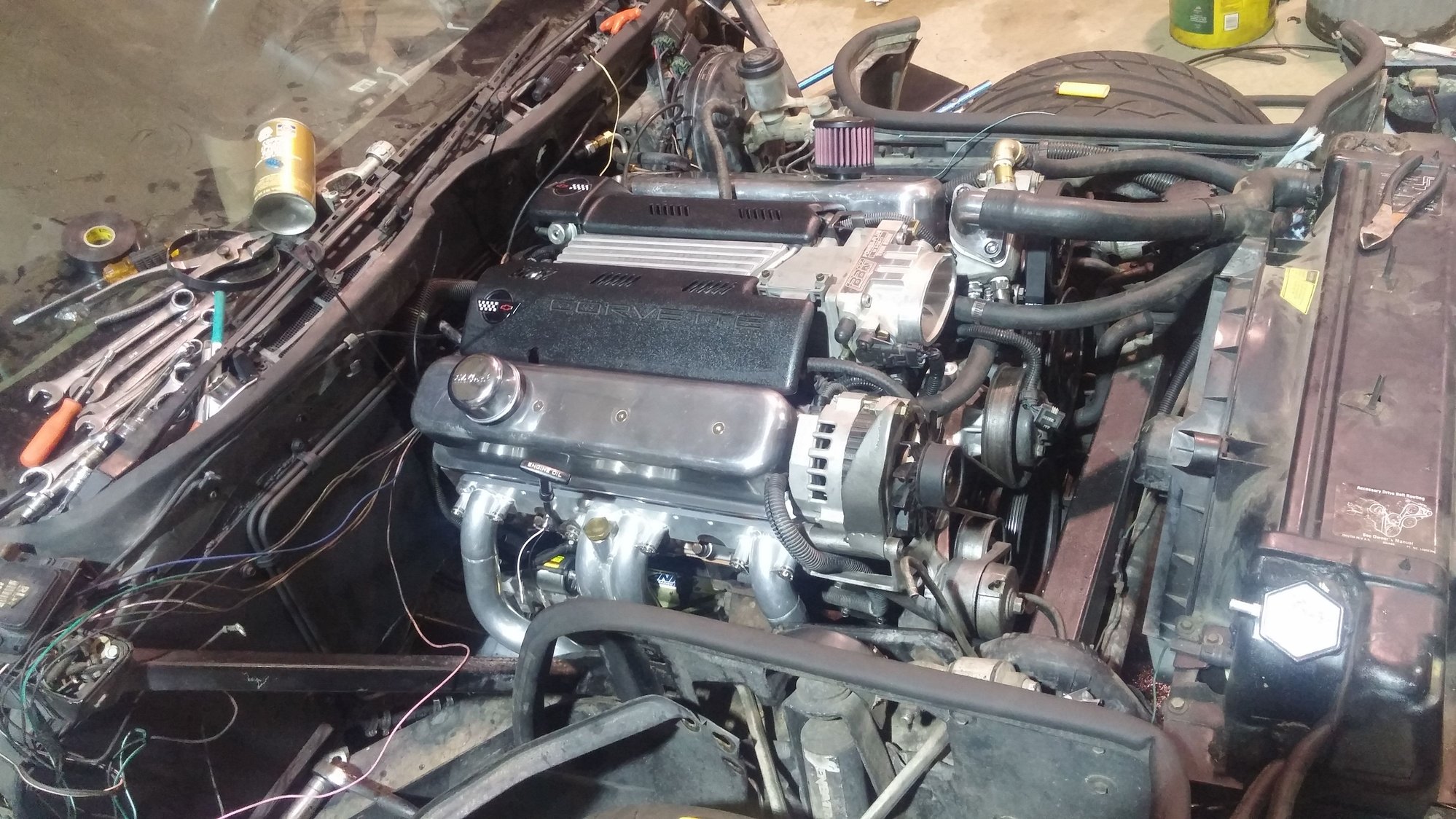

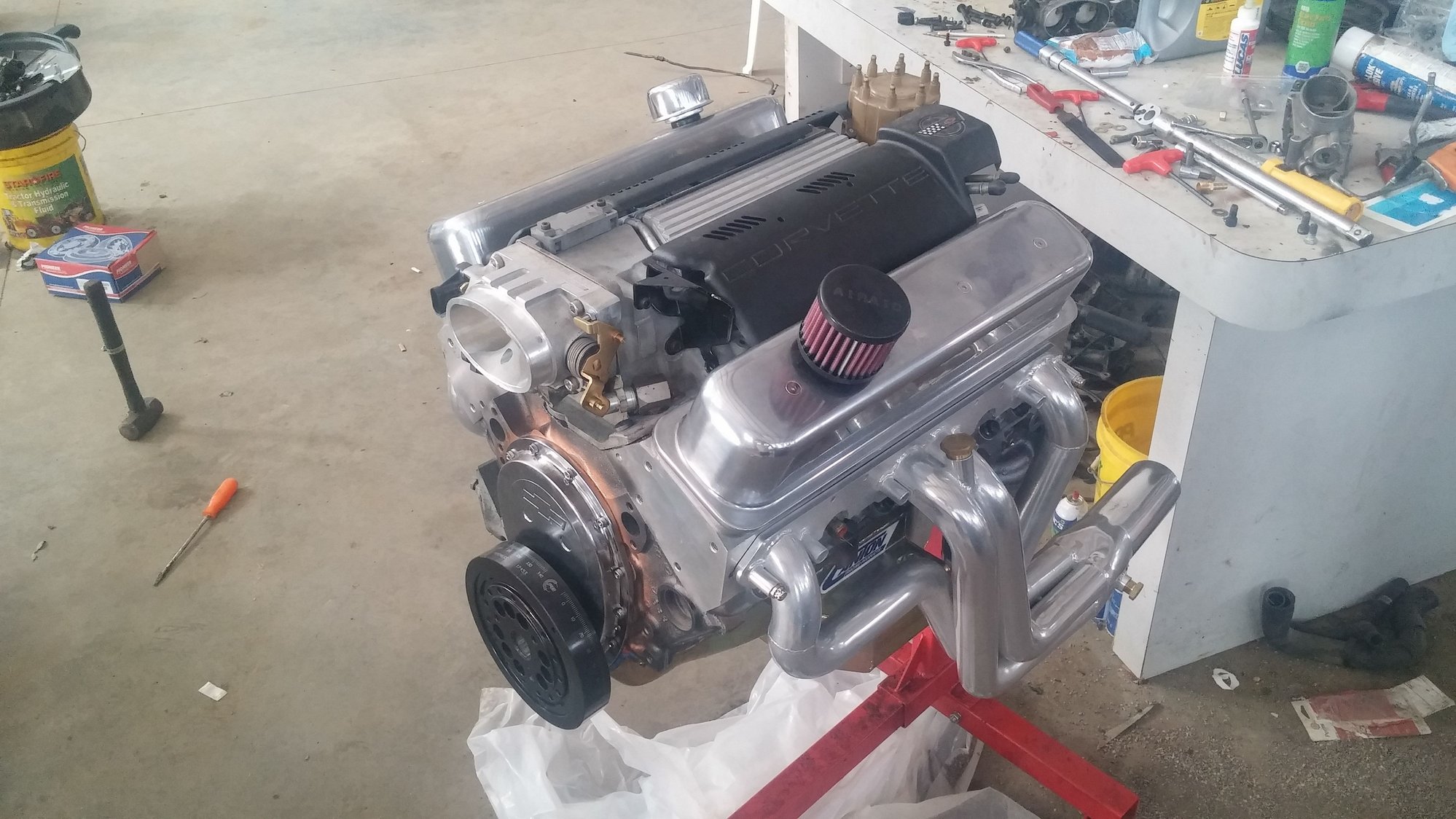

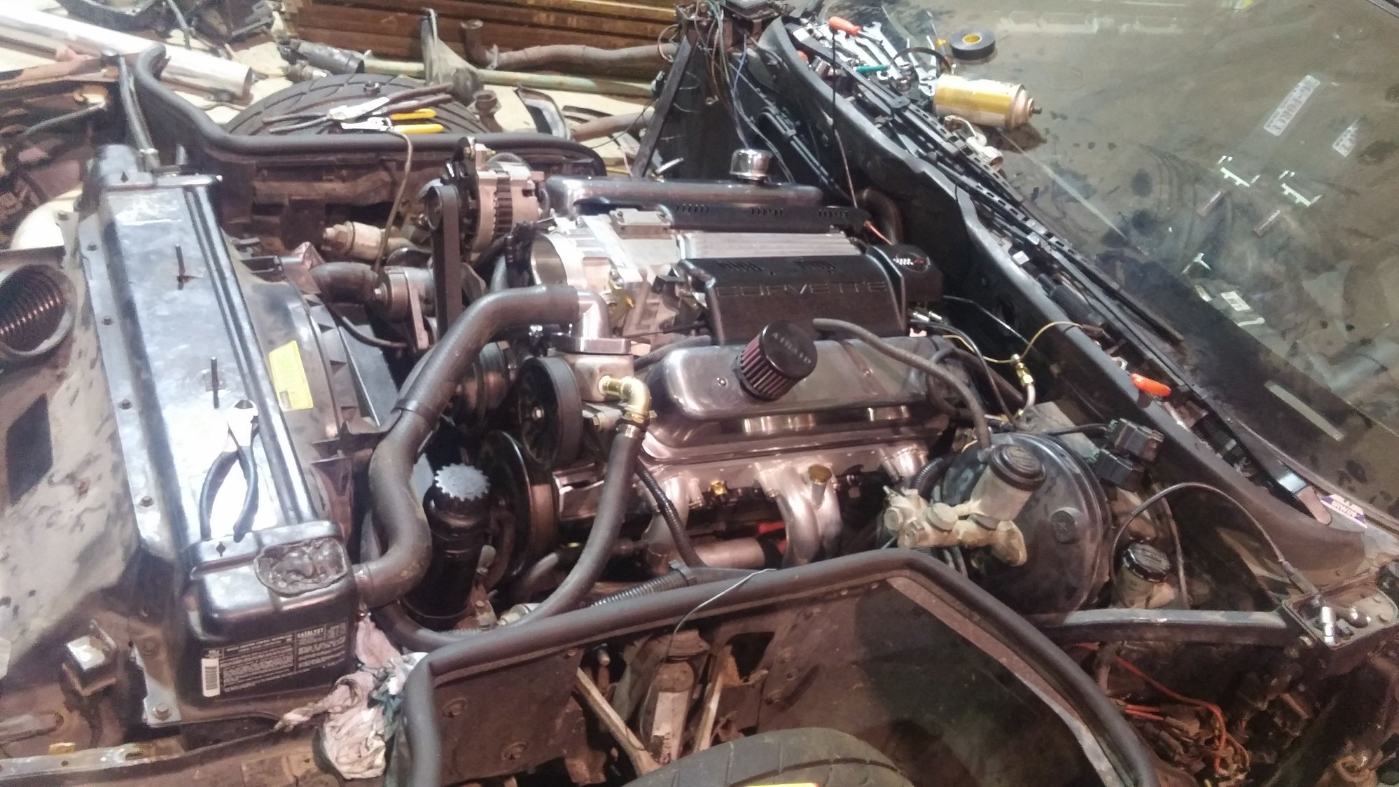

Finally getting this thing back together and should hear it run within the next week . parts list
Flat top 2 valve relief std pistons
Floated the rust pins
Race bearings on rods
Polished stock crank
200 Patriot peformance heads
Milled .028" to get them to 58cc
2.02/1.64 w/Titaninum retainers
Felpro 1094 headgaskets
1.6 full roller rockers.
Comp xe274h cam
Rhodes flat tapets
Had a lt1 intake machined to work on sbc distributor and bolt pattern
52mm throttle body
Oil to air oil cooler
Canton road race oil pan
Tpis headders (which didn't fit on the passenger side without bending it )
28psi injectors
Msd 6al
New coil
Small cap hei distributor
Old Sep 28, 2015 | 02:53 PM
antfarmer2's Avatar
antfarmer2
Joined: Mar 2015
Posts: 15,926
Likes: 579
good job but get the tools off your windshield a small chip will make a big crack!!!!!!
Old Sep 28, 2015 | 02:57 PM
jlfx car audio's Avatar
jlfx car audio
Joined: Jun 2014
Posts: 134
Lol yea it already has a crack high on pass side . thinking of replacing it with a lexan sheet (it's a track car only ) but have a 84 parts car I might Rob the class from if I want to keep it simple

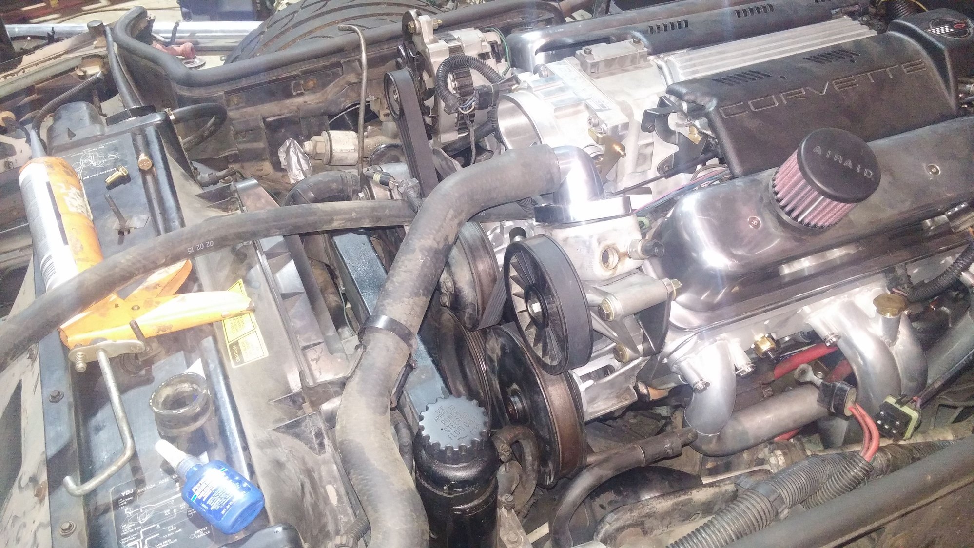

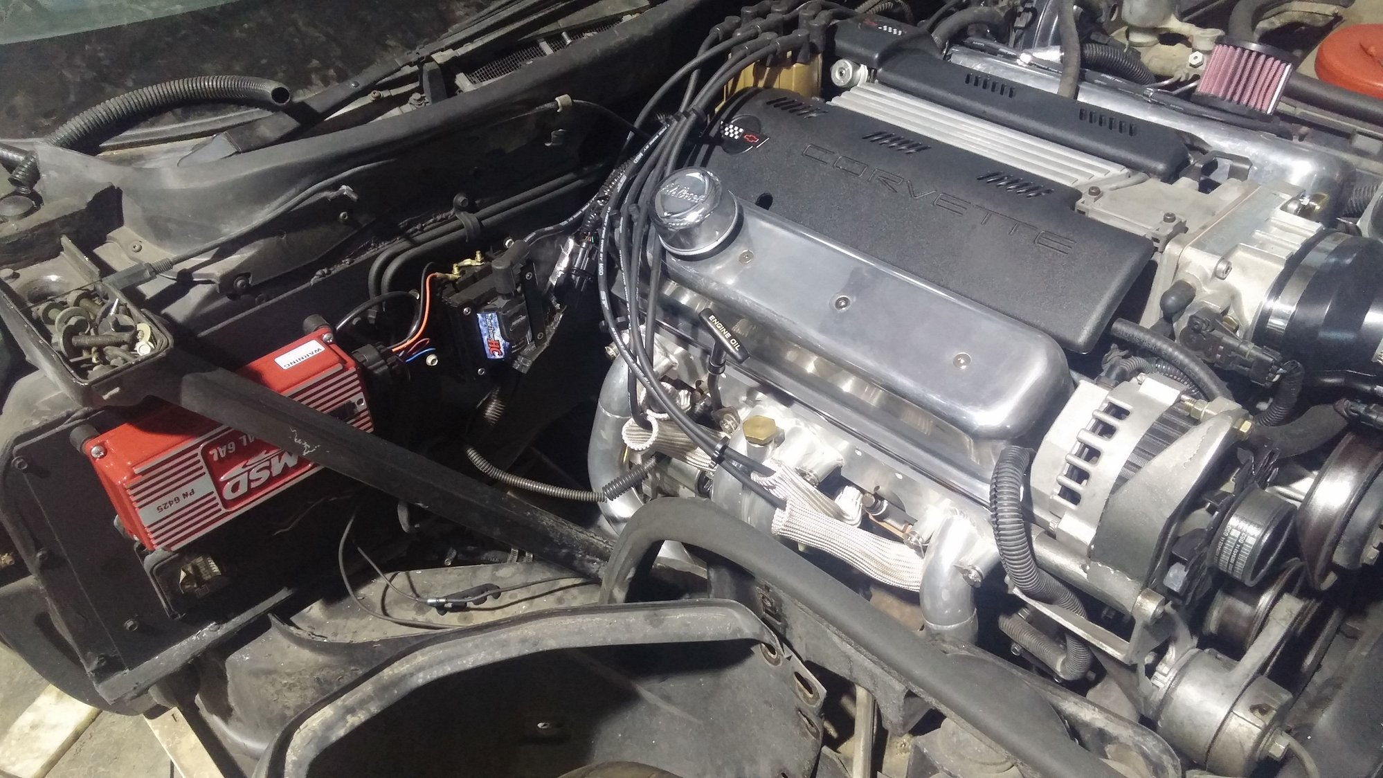

Also not sure if anyone has noticed but i moved the alt to other side and made a pully to suspend belt with the air pump (used the a/c compressor elimnator along with some 1.5" barstock bent and drilled to offer more support if anyone is interested lmk and I'll take some close up pics of the mods to do your self . much cleaner up front now
