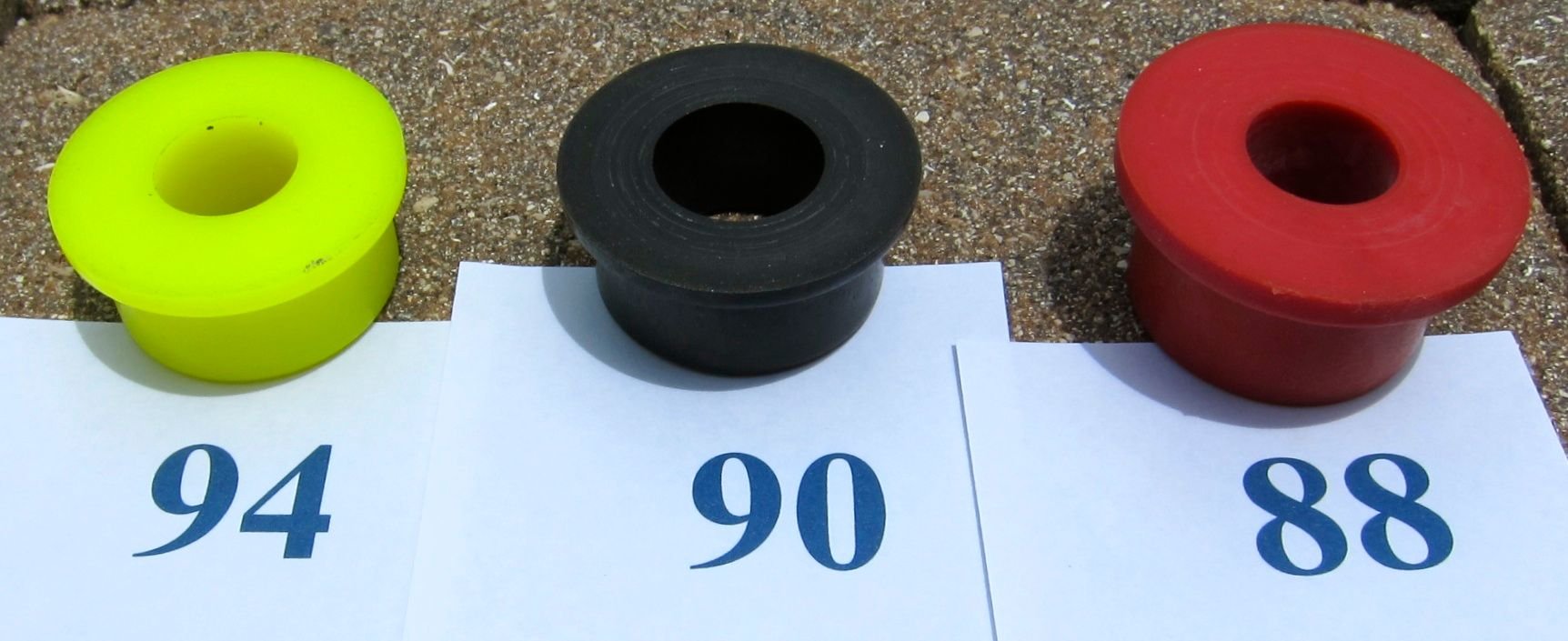

Not all bushings are the same. I measured three different brands and came up with these numbers. The yellow is from Energy Suspension.
Richard Newton

Are you saying all 3 of those are for the same year make and model yet all 3 are different sizes?

Bushing sizes vary depending on where they are used. the instructions will guide you.
I had a rear spring crack, tho it was worse than a sliver. I'm not sure I'd want to drive a performance car with a flawed spring! I happen to have two here, as it goes. One is coded RHZ, the other NYR, both way cheaper than the big guys.
I'd opt for graphite-infused poly for my next set. Currently, I lube the sway bar bushings at every oil change..

I get that they are different sizes for different components. The way he worded his post suggest that he has three bushings all for the same component from three different manufacturers that are all different in size. If that's the case then only one will be correct or possibly all will be incorrect in size if the bushing manufacturers are all that lax in quality control.
