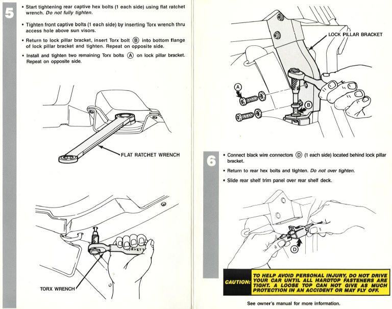

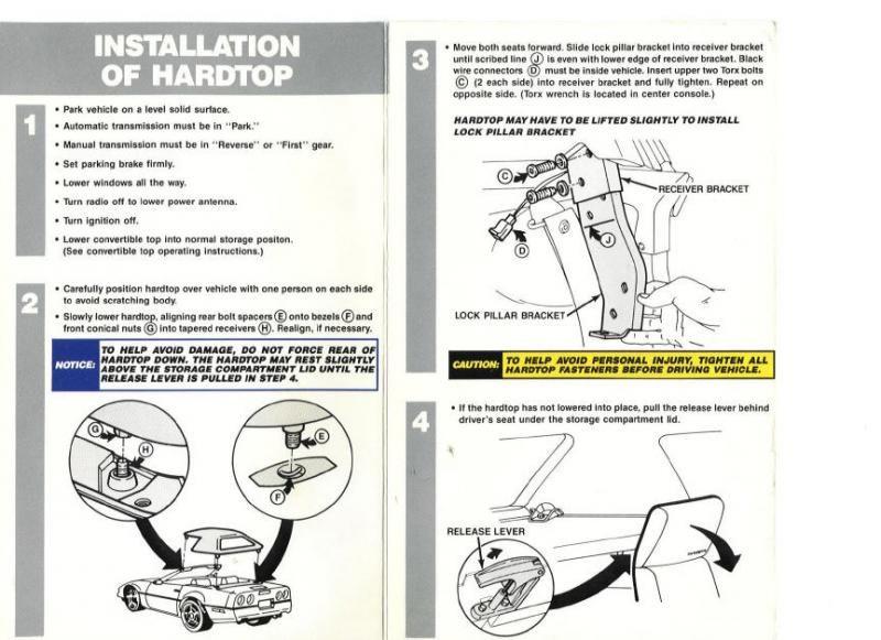

You didn't say if you got the GM Installation Guide, but here's some pics of the pages:

Didn't get the guide but I have an FSM with the instructions. I'll print up the pages you sent also.

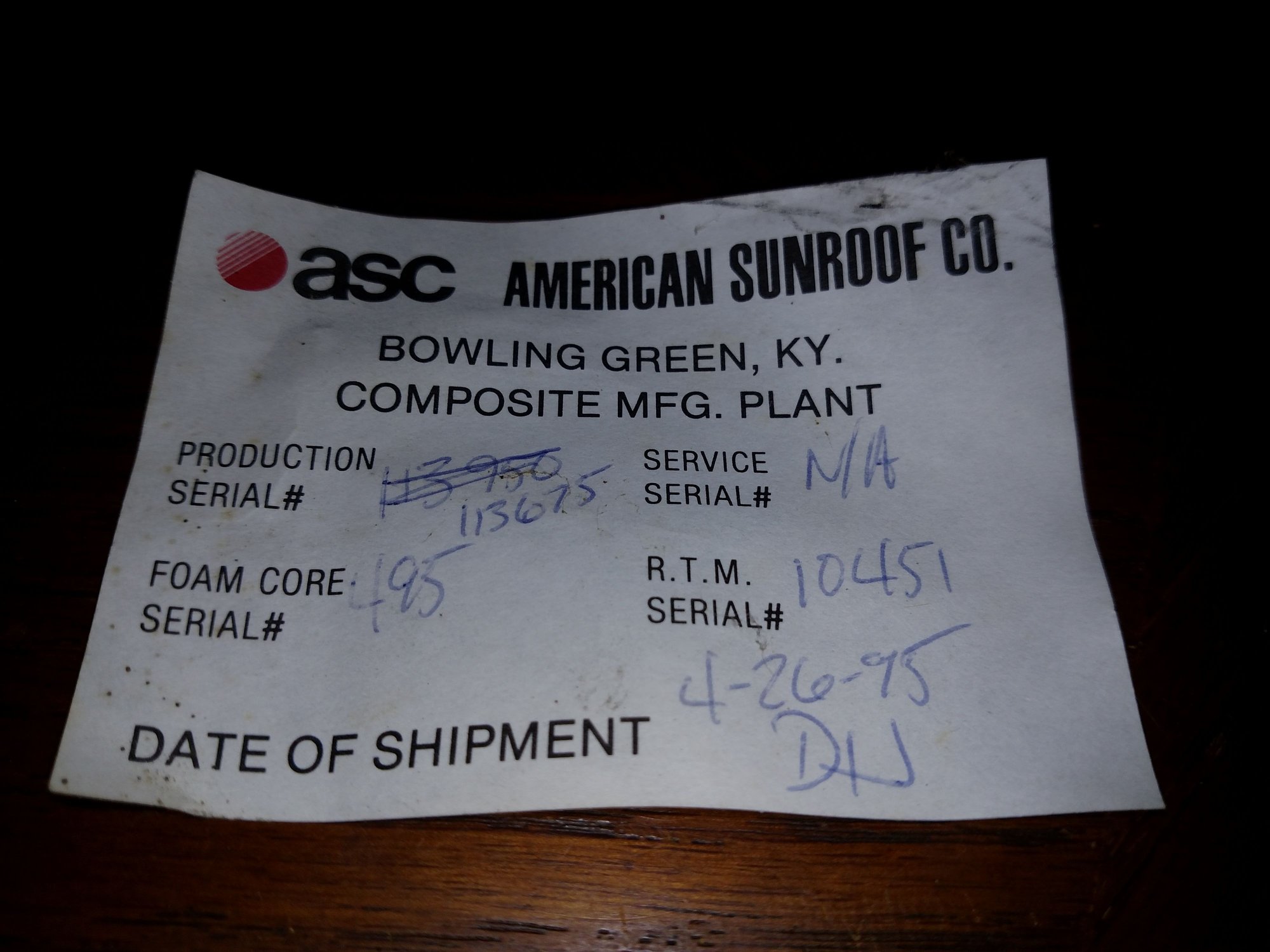

I finally got around to taking a close look at my hardtop and the below is what I found. The sticker was located inside the drivers side pillar and was barely holding on. I was able to easily remove it and have since reattached it with rubber cement. As you can see there was a mixup in the car assignment with the initial serial crossed out. The second serial matches the last part of my cars vin.

Thanks for the additional information. I didn't know about a sticker for these hardtops.
