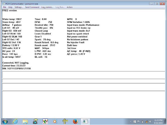

My current OE throttle body & TPS sensor is set to .61- As above the transmission is not a factor. But your Idle. If this is a stock LT1 900 RPM's is slightly High. The factory setting is 750 RPM's
