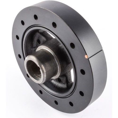

Progress report: I have been able to turn the crankshaft fairly easily after I took out some spark plugs. I felt the compression in the #1 spark plug hole. However, everything is so dirty that it's hard to mark out the timing mark on the crankshaft pulley. Does anybody have a pic of it?

It is more than a "mark"....it is a machined slot about 1/16" wide and about the same depth in the balancer. Take a rag and wipe off the outside of the balancer.

After you clean it up, put some white paint in the slot. "White-Out" correction fluid works great!
