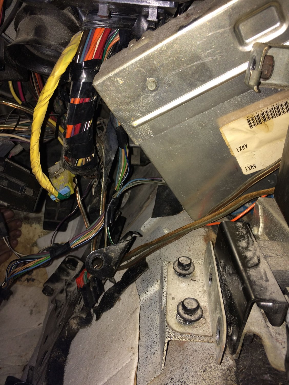

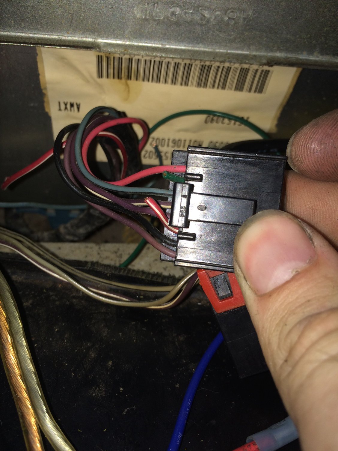

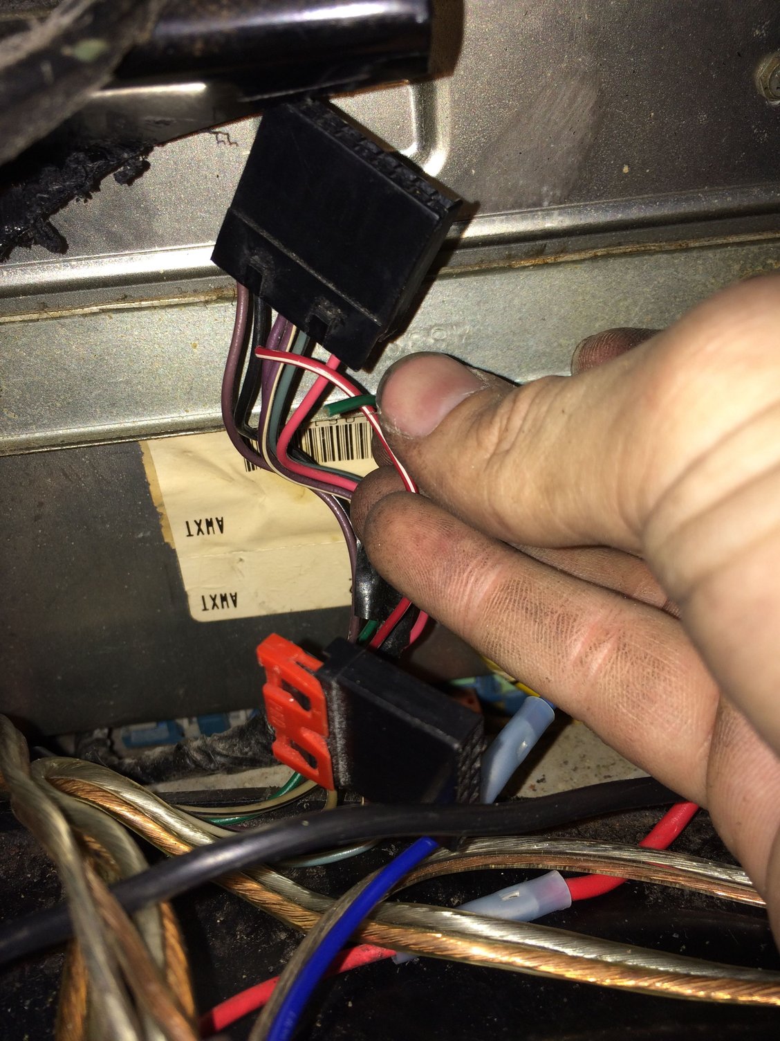

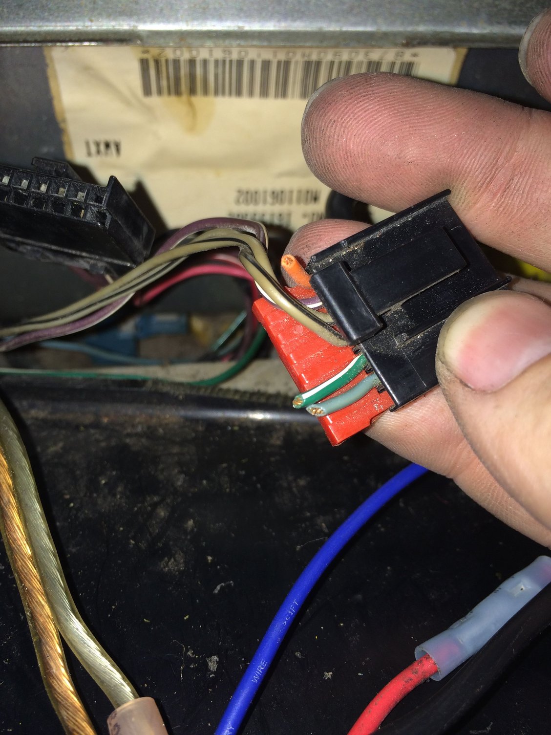

Found behind the radio, I believe it is the stock radio plug but I am researching to confirm
Stock radio harness?

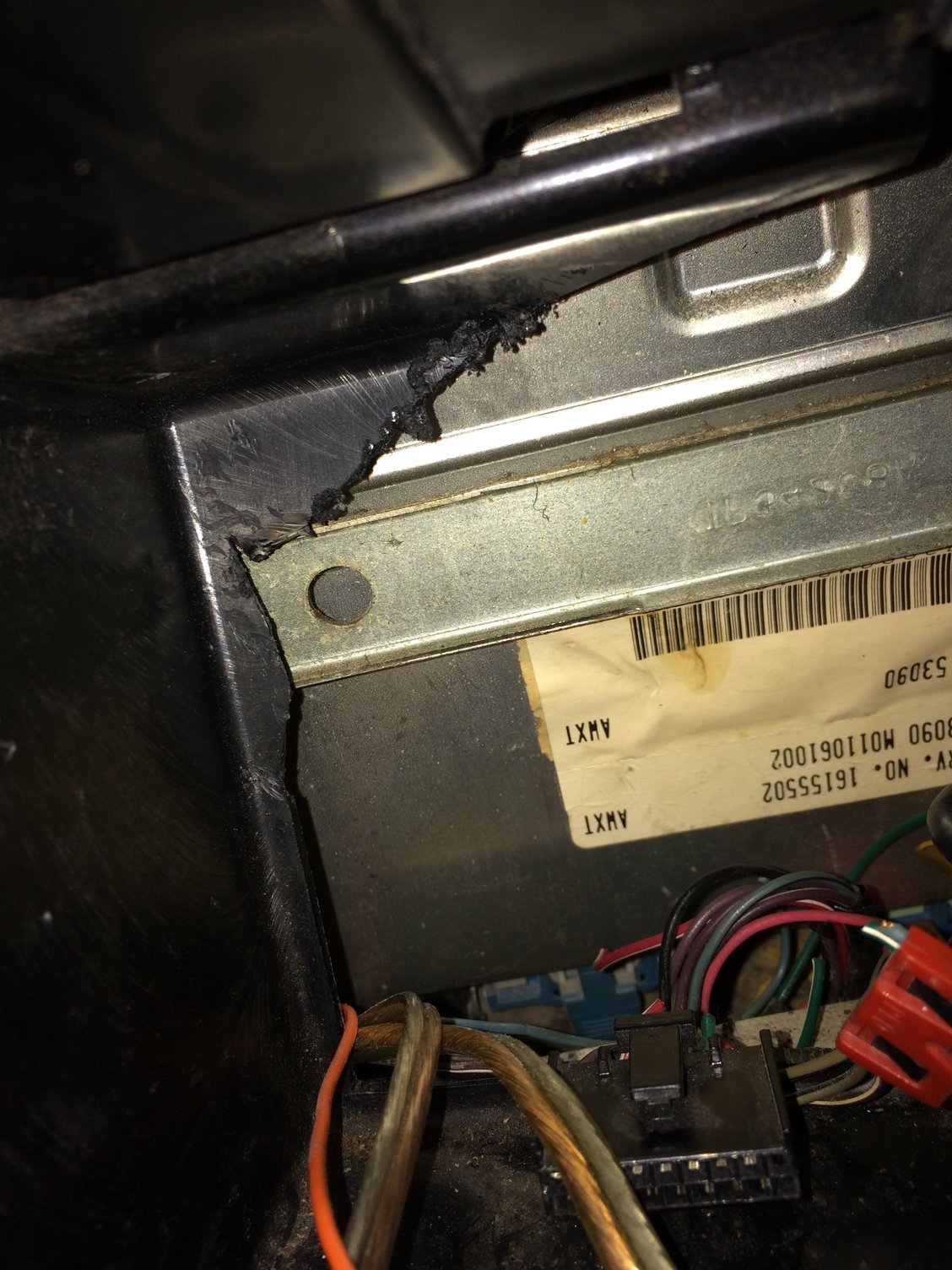

CCM unit
Is this damage from the factory or has someone attempted to get at this before

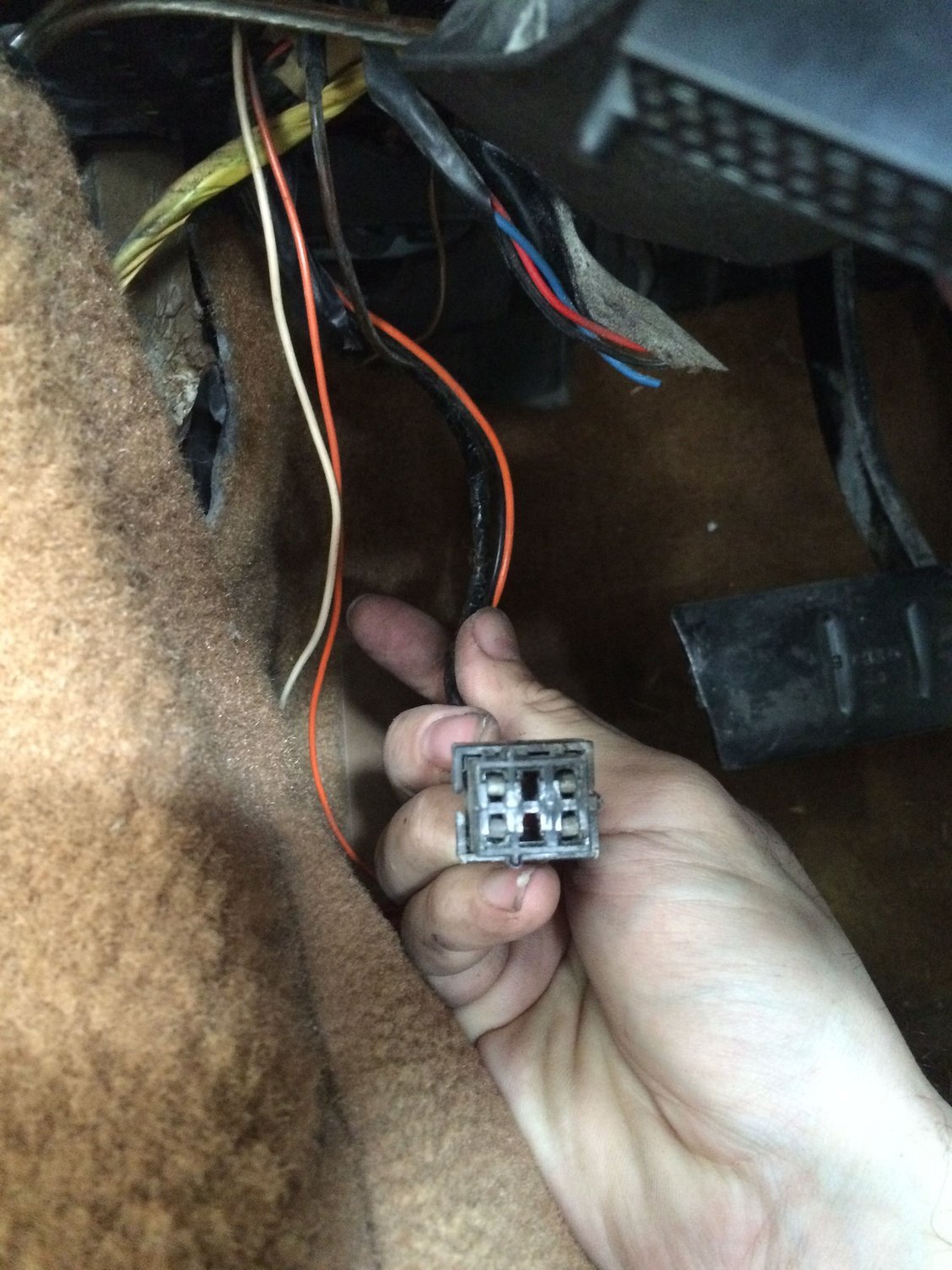

3 single wires at the left footwell on the driver side, I can not find where these may connect so I am researching
Single plug at the left footwell on the driver side, I can not find where these may connect so I am researching

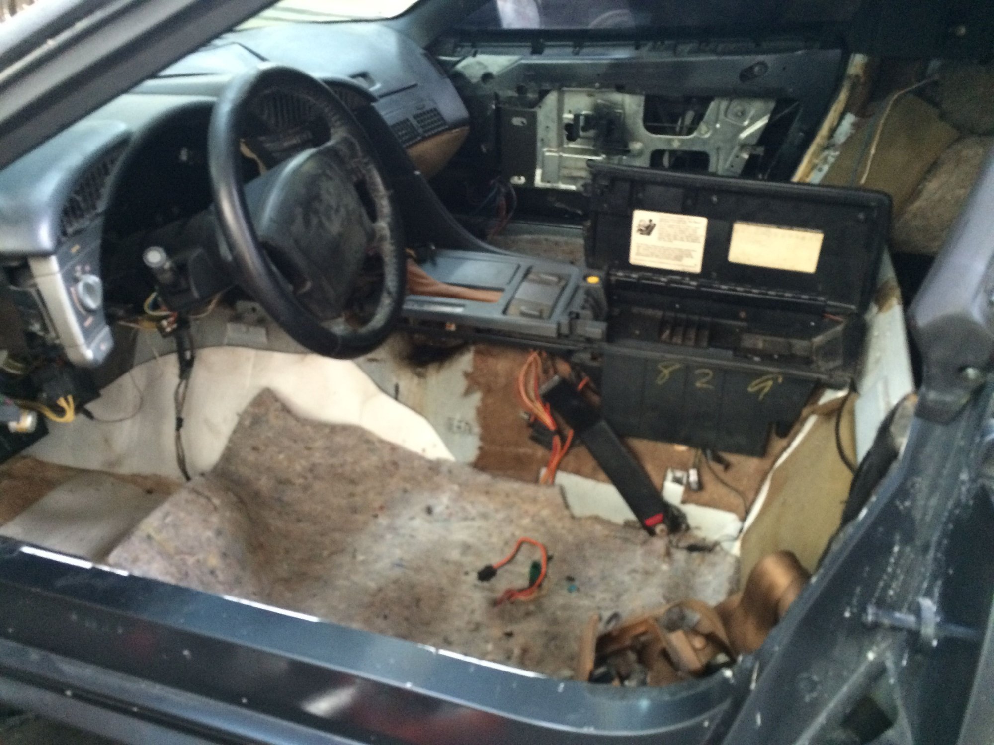

Somewhat current state of the interior, carpet and seats removed. I have also pulled the center glove box/console
How far the CCM will come out as is with all brackets removed, but unit still plugged into harness. The CCM makes contact at the bottom left and top right so I can't get it out
Hardly "factory"!
You, sir, are in dire need of a FSM with wiring diagram!

That is known to Car Stereo Installers as an EHJ...Epic Hack Job. FSM, good quality wire, soldering gun, and heat shrink, will fix the wiring right up. May the Force be with you!
