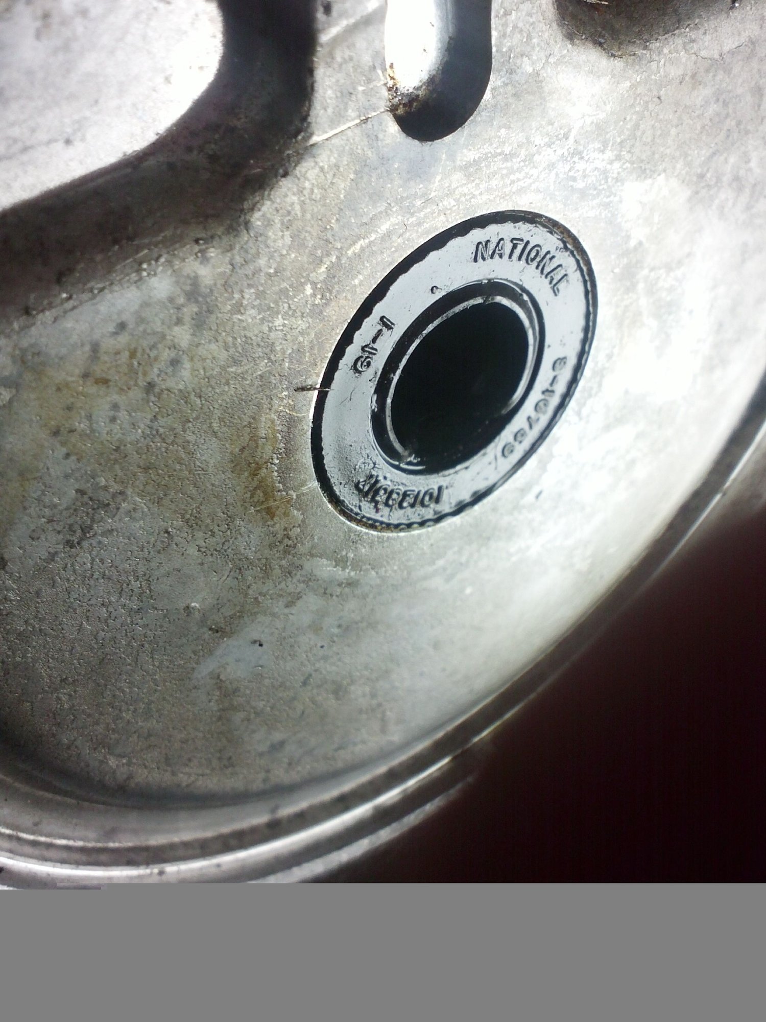

Hello friends.
Well, I'm midway through my 3rd opti replacement in 7 years, and have run into something I'd like to run by you. In the hole on the timing cover that the optispark drive shaft goes into, the bearing looks funny to me. The ring around the outside edge, instead of being constant all the way around, dips down at a point. I took a picture of it to show you. Is this normal, and if not, where do I find this bearing and how do I get it out. The water pump bearing has a spot for a screwdriver, but I'm not seeing that here. Help before I break something!
Bob

that is a seal replace it as well as the water pump one.do some reading they can be tricky. there is a tool to install some use a sharpy. carefully drill a small hole and put a screw in it to pull it out.

I've looked everywhere for it, and for instructions on how to do it. I don't think it's even covered in the FSM. You can buy the whole cover with both seals installed for $149, but that seems like a job too.

Thanks for all of your help. In getting the opti seal out, any word of advice? Do I just try to pry it out with a screwdriver? There's no place to get to it like on the WP seal. Sorry for all of the questions...

Oooo. I found this as I did what you said and started googling.
2. Opstspark seal.
This one was embarrassingly easy out and in. I used the $5 seal removal tool I purchased at Harbor Freight; it worked like a champ. Putting the new seal in was as easy as getting it aligned with the hole and tapping it in using the proper socket.

Yes, just pry it out and gently push the new seal in by hand. It's that simple. This seal doesn't require a special tool like the water pump seal.

Well, both seals came out without a problem and the new ones installed easily (as you already knew they would I'm sure . Unfortunately, I appear to have the wrong Optispark unit as it has a vent tube on the bottom that is getting in the way of the crank shaft. It's probably the one that goes to a 95-96. Oh well, I scraped off the gaskets for the water pump and will get the opti swapped out tomorrow. Thanks for your help locating those seals.
