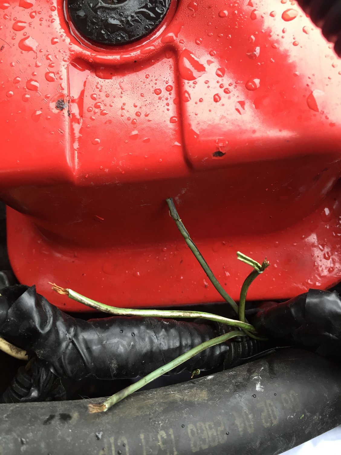

Here are the 4 ICM wires

Somebody. Must have replaced your wires. Absolutely Should have 2 Pink 1 White 1 Green/ white

Thats what im thinking i guess ill have to start peeling back and digging...ill update when i do so
