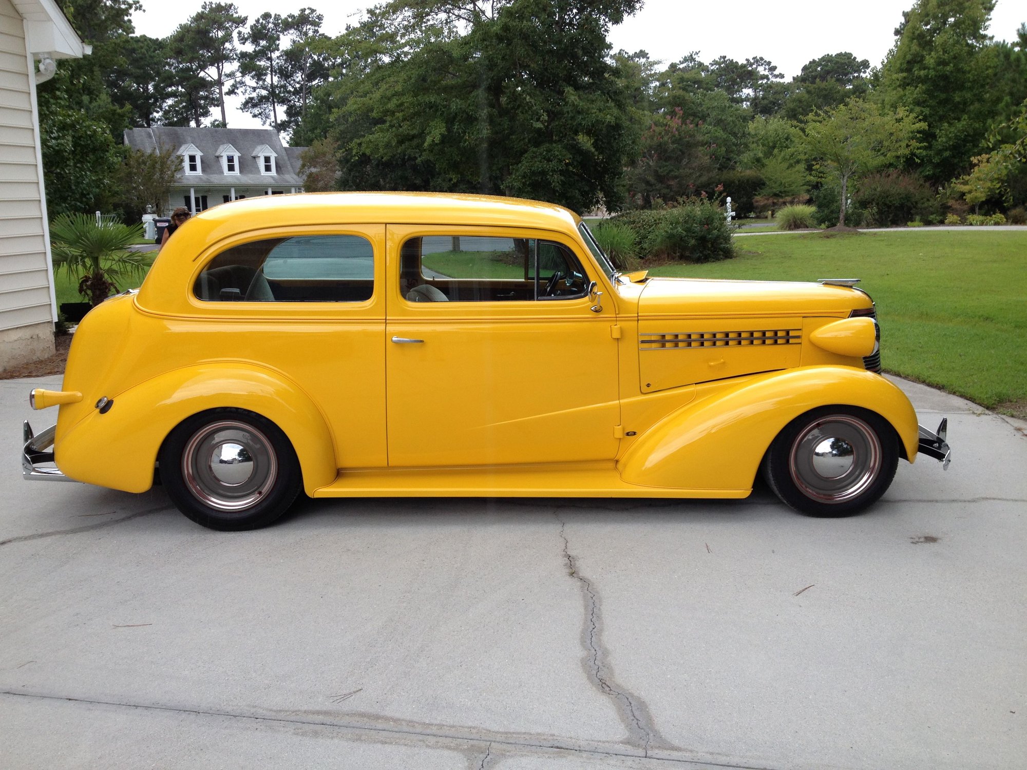

Greetings, I have been in the C3, C5 and C6 forums in the past and finally have a good reason to post in the C4 section.
The car I am asking about is a 1938 Chevrolet Master that has a 1985 Corvette suspension.
The car's alignment is a mess to say the least but with steel wheels and soft sidewalls is a decent cruiser. I am looking to upgrade to some bigger wheels and want to get the suspension set up to have good driveability.
The car is a cruiser, not driven hard and I would like to know what settings you all recommend for camber, caster and toe in the front and camber and toe in the rear.
I appreciate the help!

Nice cruiser, and beautiful color!
I think it was in '86 that Corvette upped the front caster to 6*. That's what I'm using on my '84, and the directional stability is much improved. That's what I'd recommend.
