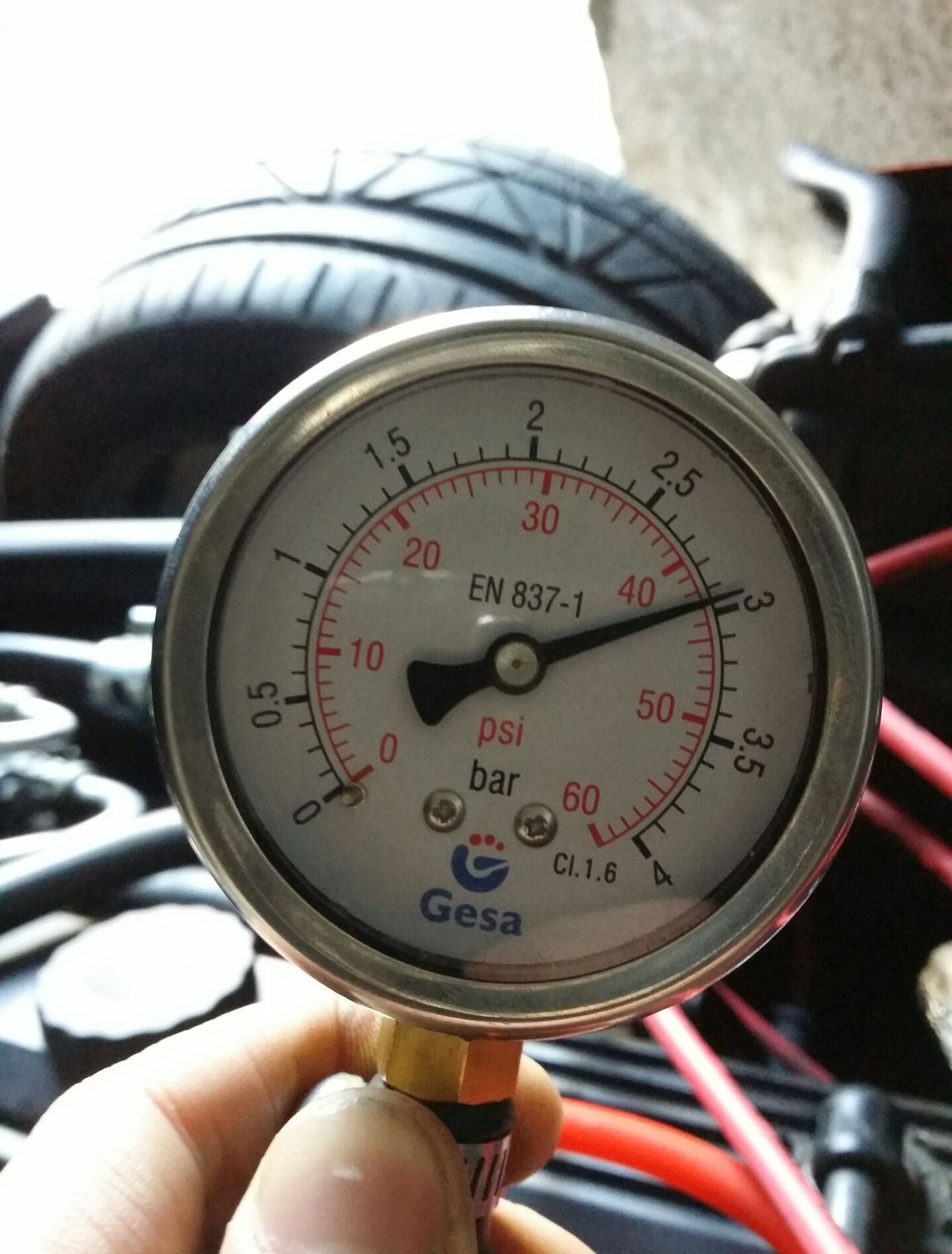

Got 43psi of fuel pressure with the ignition on. Waited a few minutes and it wouldn't drop.<br/>With the engine running the pressure goes down to 35-37psi and stays there (on idle and engine load).<br/>Fuel regulator seems fine, pressure increase when i remove the vacuum line and no fuel residue.<br/>Im guessing my fuel system is fine?<br/><br/>Sorry for keeping u guys busy with me<br/>Thank you

Got 43psi of fuel pressure with the ignition on. Waited a few minutes and it wouldn't drop.<br/>With the engine running the pressure goes down to 35-37psi and stays there (on idle and engine load).<br/>Fuel regulator seems fine, pressure increase when i remove the vacuum line and no fuel residue.<br/>Im guessing my fuel system is fine?<br/><br/>Sorry for keeping u guys busy with me<br/>Thank you[/I]
Seems ok. Usually the test is done with the engine running and vacuum line disconnected to simulate WOT. That it holds pressure is good, assuming you are stock. What happens when you do a WOT run on the road? Pressure should momentarily drop but hold at about 43 or so. I know mine does.

Originally Posted by eliebarcham

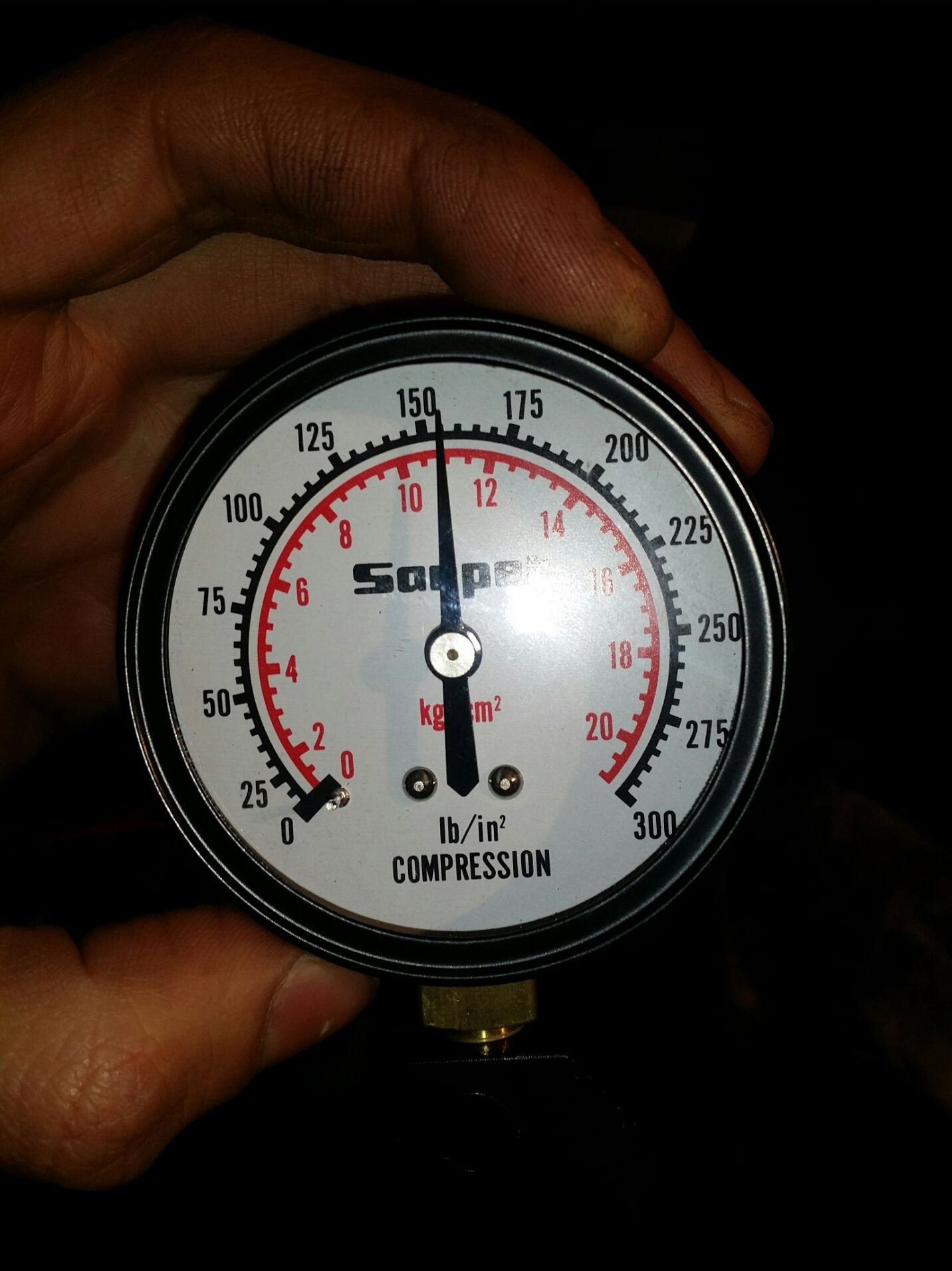

Bought a new compression test gauge today, took off all spark plugs, full throttle and cranked up the engine. I pretty much got over 150psi (range 150-160psi) on all pistons. Happy with that seems like i had a bad comp gauge.<br/>Next step is to check my fuel pressure hoping id get over 40psi
Now your Cranking!!!! Your previous gauge reading. Was out of scope for your Mileage.
as above keep the FP gauge on the windshield toward you. Monitor while driving then WOT.
if your pressure drops down. As you already stated 35Psi.. It's almost a guarantee you have a weak pump.
other defective sensor components would not drop your pressure.
