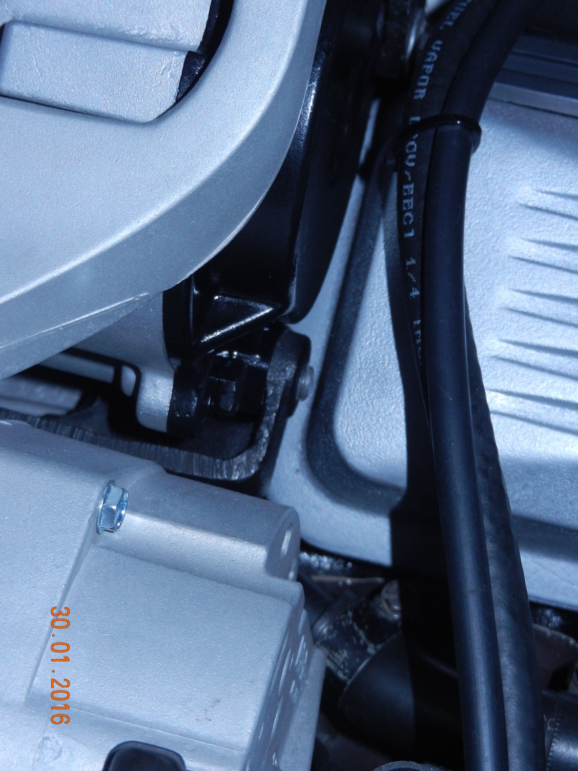

Driver side, I did not have to remove the window wiper motor cover but did have to back out a bolt I believe is on the A.I.R. bracket. You'll see it next to the valve cover.
If you cut the end off the bolt you won't have to remove it in the future:
on the 86-91 L98's - however, the OP has an 85 - different configuration
to remove the LH valve cover on an 85, the smog pump, and pump mounting bracket must be removed -

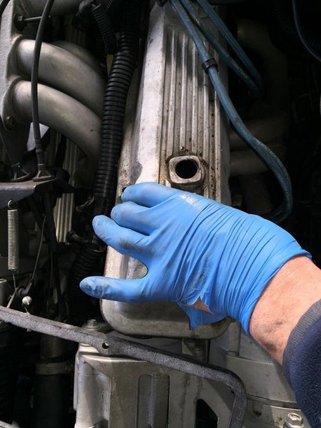

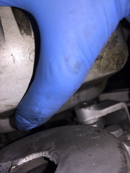

i'm able to take off my 85 valve cover just loosing that bolt flush ,it's a little tricky but it comes off,i never removed the air pump bracket/assy...

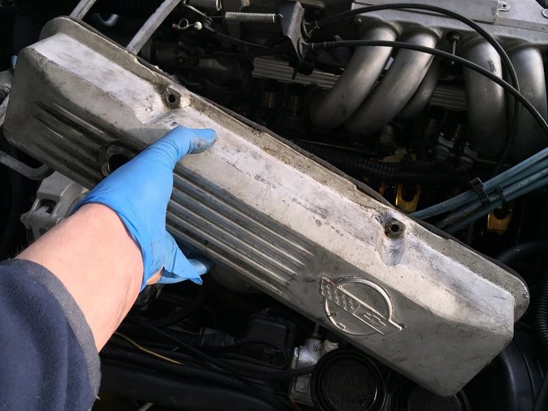

technically, you may be correct! not saying you can't do it, in fact, the FSM says nothing about removing the pump and bracket, but it looks to be a major PITA. FWIW, i've done this several times, and personally, always removed the pump and bracket. it's a lot easier to lift the cover straight up vs jockeying the VC around to clear rocker arms and the VC's internal PCV baffles. EDIT: IN MY DEFENSE, I TEND TO DO THINGS THE HARD WAY - - anyway,

Hi Joe,i just replaced my gasket one hour ago,i have done my passenger side a couple days ago ,and i did the driver side in the meanwhile from my last post...straight forward, i just put gloves on my hand, i'm quite confident with the top end of engine...but i've never gone deeper than the injectors rails and RR...
