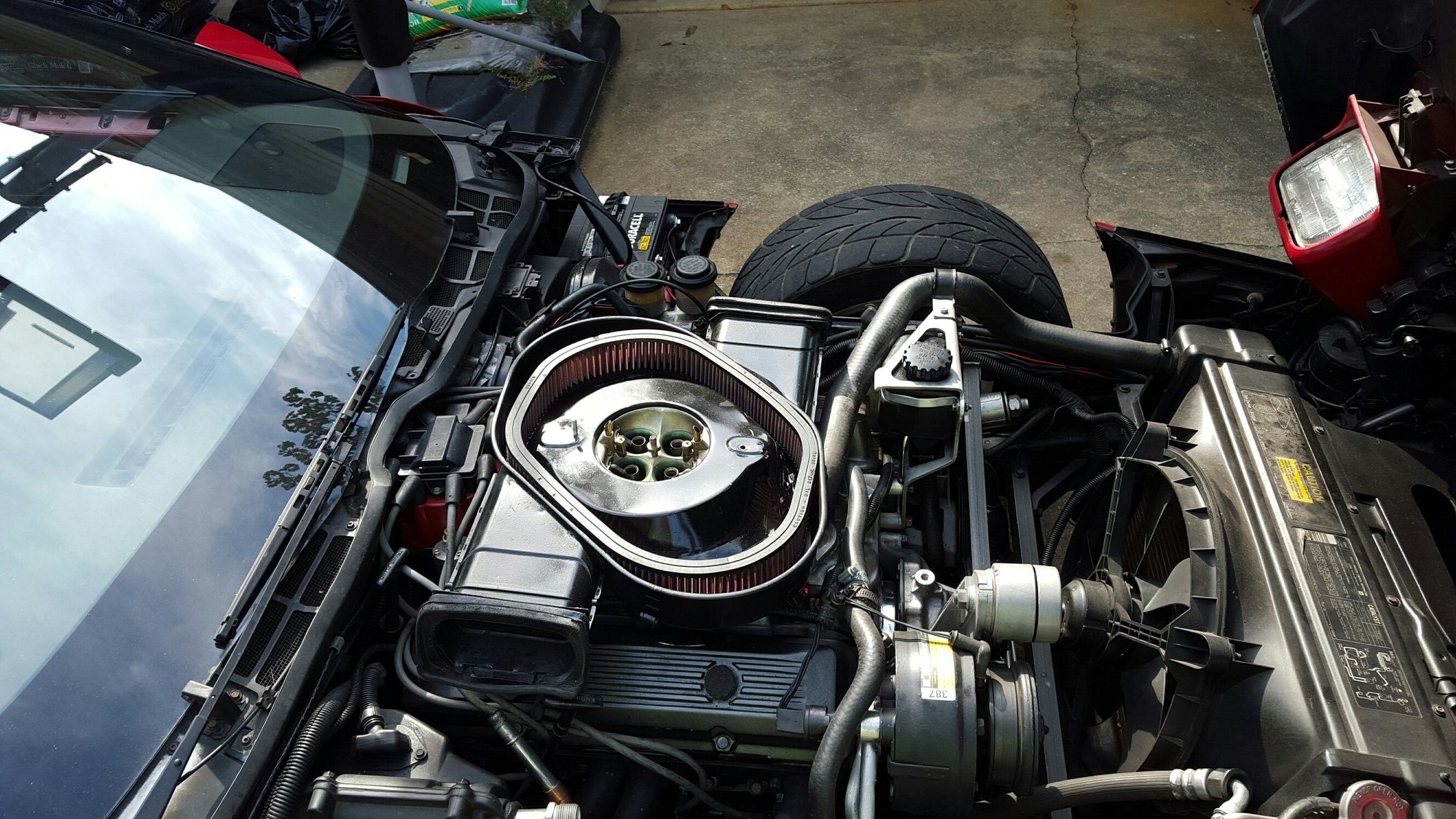

I would suggest a return fuel system. I have never had a fuel overheating problem like some others have had. As far as a manifold is concerned the only thing you need to make sure is to get a manifold for vortec heads if you have them and of not dont. here is a pic of mine i was evev able to use my original air cleaner housing,modified of course

Frankinvette, that's an interesting conversion! How do you put oil into your engine? Or maybe you've fixed that.

When I built my engine, I traded sides with my rocker covers to put the oil fill port on the drivers side, to stay away from that fragile high pressure switch on my a/c compressor (which Frankinvette's not using anyway). But to put the oil filler under the air cleaner looks to be a little inconvenient!

Thanks the pics posted are a bit dated.( you can see there is a strap holding up the back of the engine while the trans was being built.) I am VERY happy with build so far.It has a forged bottom end Dart heads and a custom ground Lunati cam. the carb is a RaceDemon with no choke. I though that might be a problem but i ran it the day before the snow here in NJ and just feathered the accelerator for about a minute and away I went. as Im typing I am dropping my dana36 to replace it with a 44 that i found here on the forum it already has 4.11 gears it and matched up to a 3200 converter it should be fun at the green lights. I just hope to show you it only matters what your goals are. You can do just about anything with these cars they are reasonably light, handle GREAT! and with some effort, ingenuity,and this forum. Fast and fun.

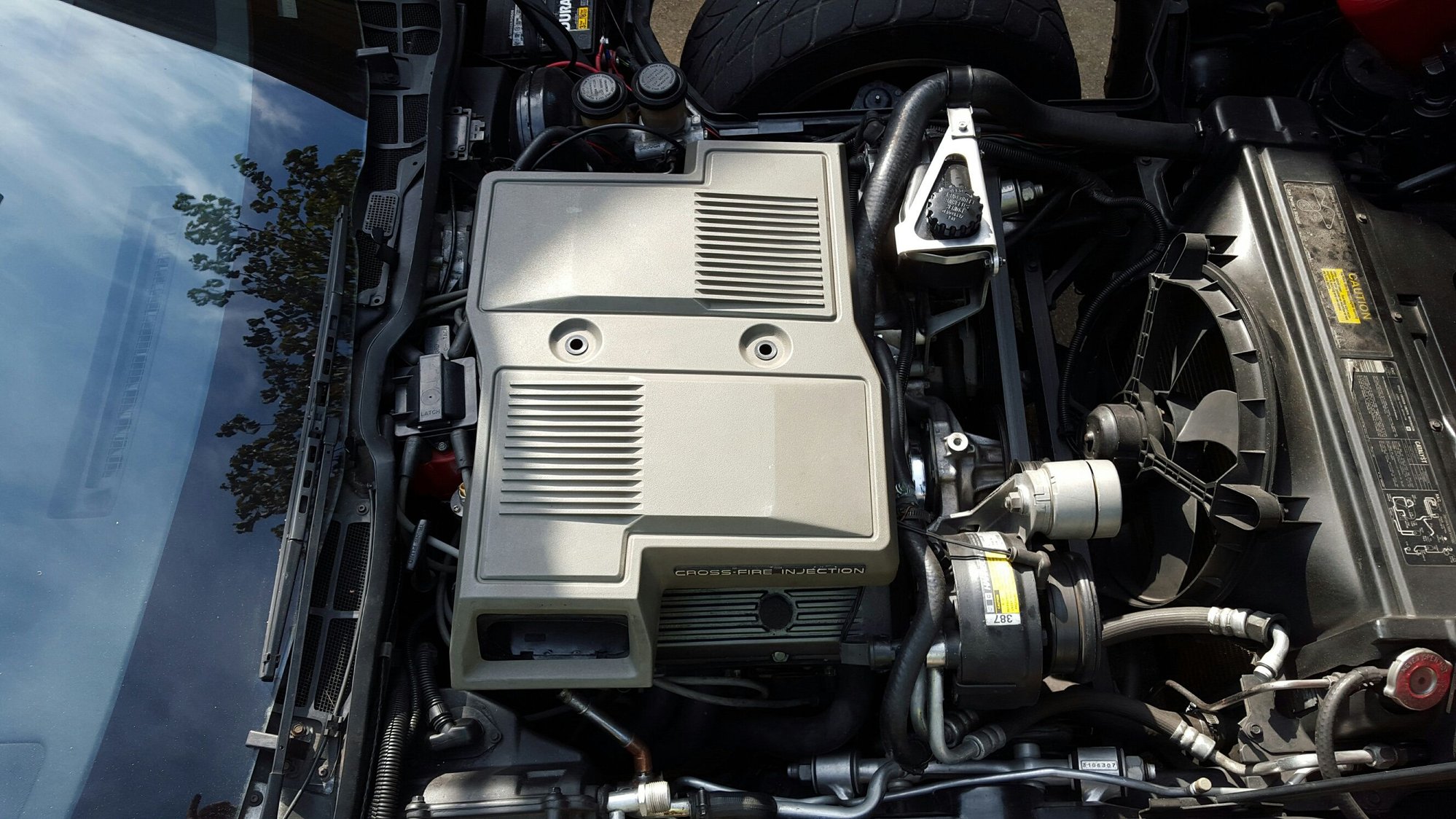

I have been running a Mallory 140 mounted underneath the stock fuel tank with the in tank fuel pump removed and replaced with a pickup tube. Been working flawlessly for a good while now.

Project C4 ,Very nice and clean engine compartment.
I would love to pull the climate control but I still like using 'em, even if its not very often. I hope to have my a/c hooked back up by spring.Is your a track car b/c i see the wipers r also gone.Once again very clean look.
