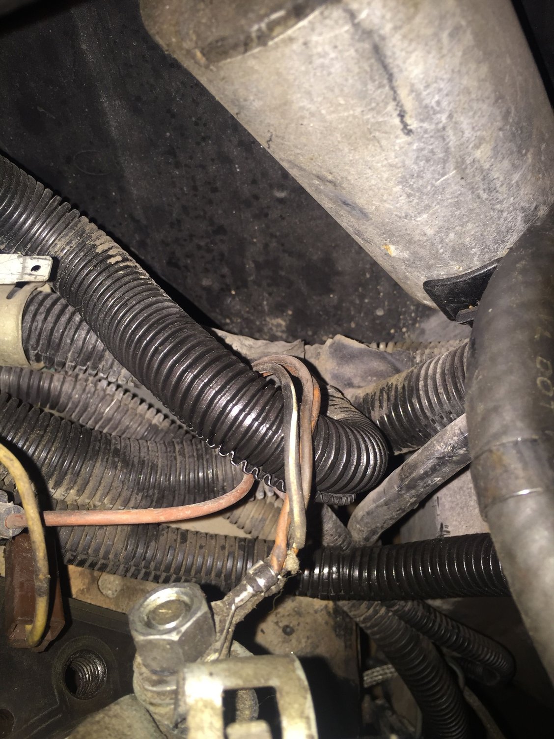

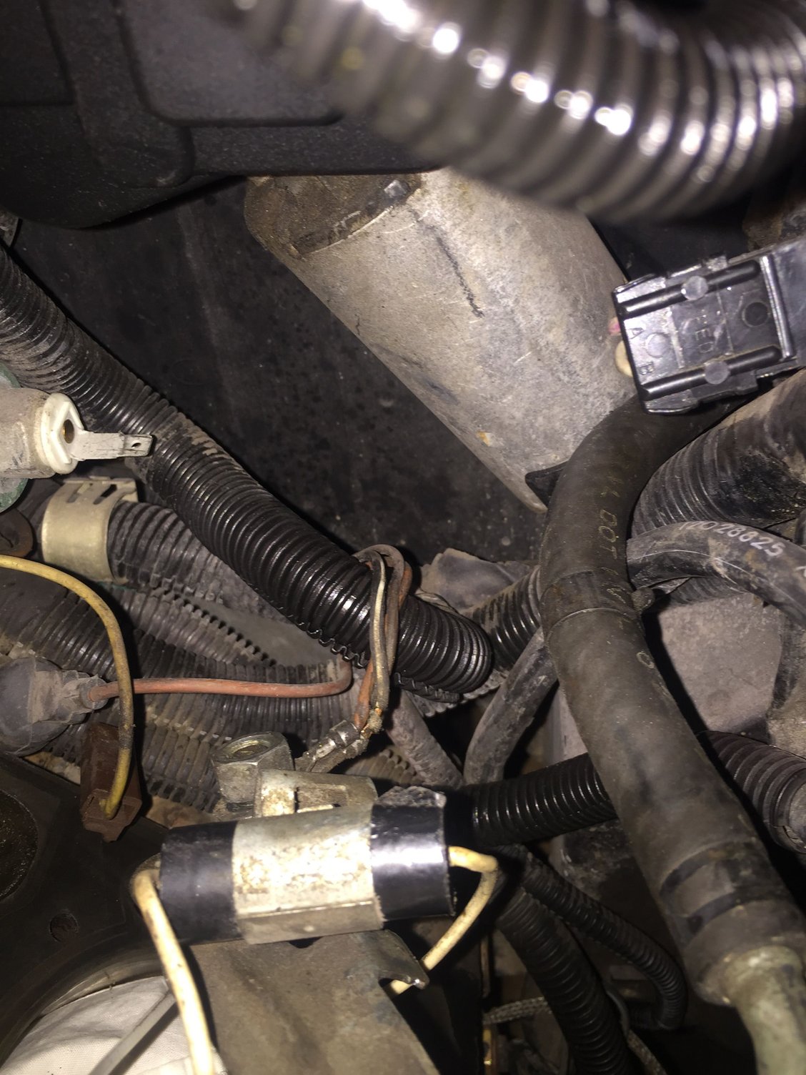

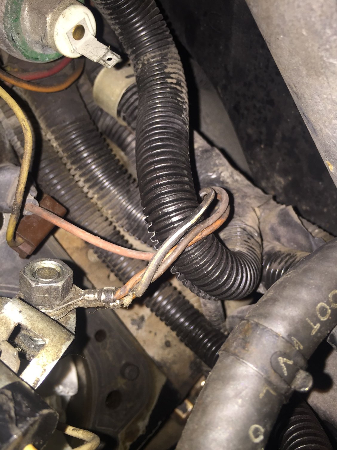

yes a finger on the injectors you should feel ticking. Or use a stethoscope.
There are two eyelets that terminate/ground on to the firewall side of the passenger head on my 1985. Pictures below, there are three wires but only two eyelets. I cannot see where they come from. there is also a bracket that holds something to do with the distributor but as for grounds there are these three wires with two eyelets. If anybody reads this and knows what those are grounding I would love to know as a sidenote.

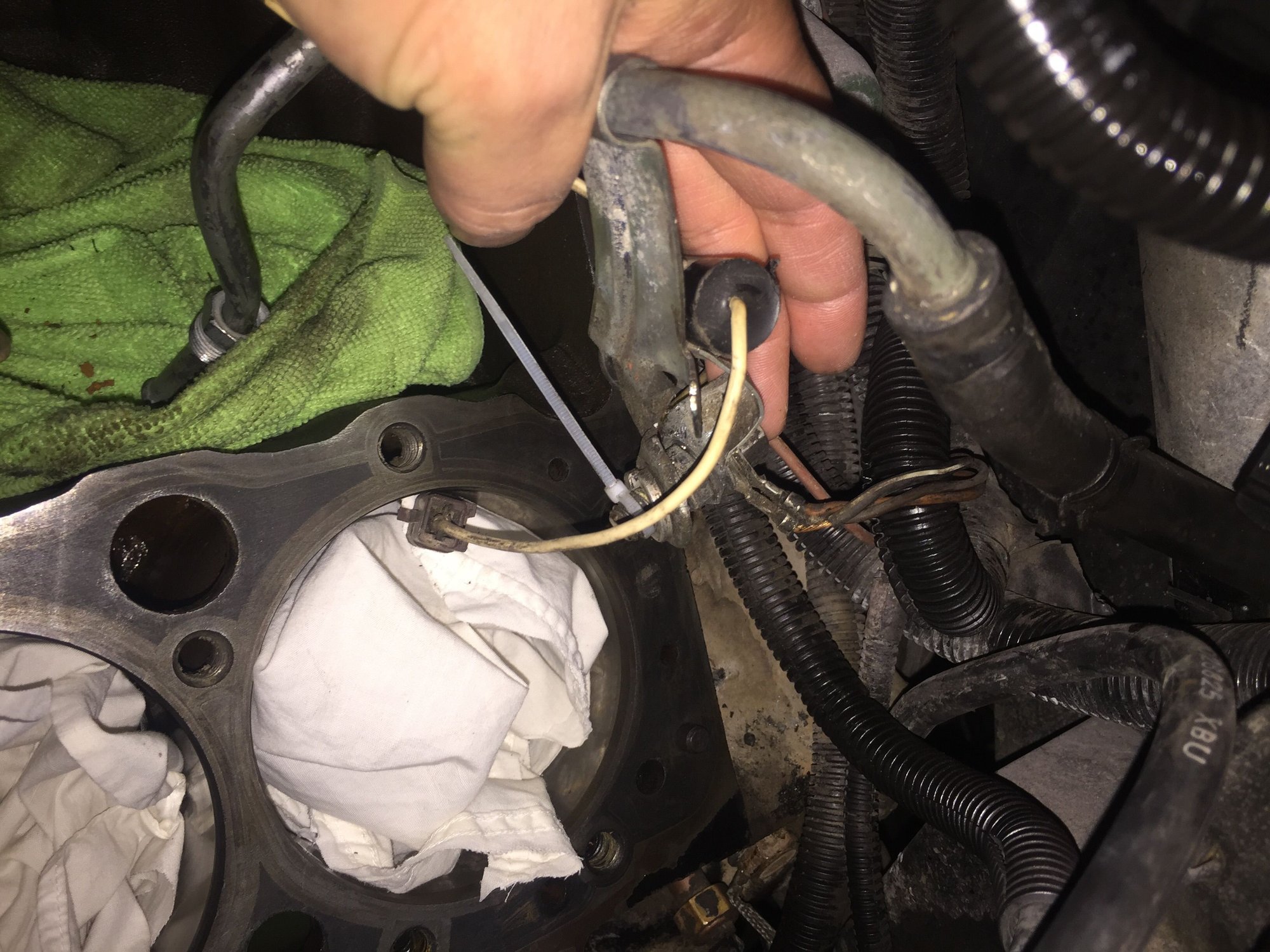

I did find a cluster of grounds on the drivers side, just above the oil filter on the block. makes me wonder if they did some things different on the convertible?
just saw your pics, I think they are the same wires. I will try and get a pic. h

they appear to joinup with a a bundle that runs back to the firewall bundle that goes behind the battery.

This is what I found.
GM moved the grounds around on various years. I know my buddy's '89 had that wad of wires attached to a bell housing bolt. Mine go to the bolt on the side of the block that the negative battery cable attaches to:
Yeah that looks like mine. (YOURS is much prettier) Ok, so I'm not loosing it! My daughters friends do call me old. Lol. h
