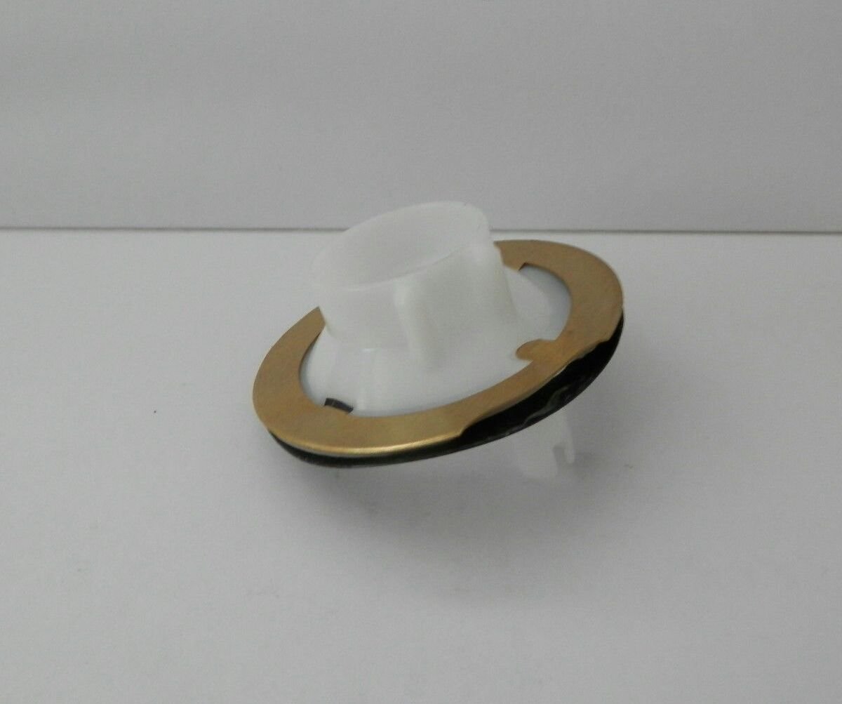

Horns>> High & Low note. Be careful. Many Horns have GM part numbers. that are actually cheap Universal Horns.
un-plug your Horns run 12V to them Directly. if the horns are working. connect a volt meter on the horn connector. get a Co-partner to press the horn. check for 12V
the plastic twist lock inside the steering wheel gets brittle in age and splits. if so simply drill another half moon hole. to re-lock.

the plastic lock is just behind the wheel

the plastic lock is just behind the wheel.
PS. touch the red lead to the lock plate.
this picture is worth a 1000 words. thank you for supplying it.
that white plastic connector hAd a slot/notch in it and a turn and twist spring loaded metal contact horn wire connector.
the slot/notch on mine broke and the spring-loaded turn and twist horn wire connector would no longer stay connected. it would pop out.
anyways, that white plastic connector, behind the steering wheel is what you need.
i cant remember (sorry) if its part of the turn signal cancellation cam or what.
they were still available nos when i fixed mine in early 2012
btw. mine is a 93

The part is a horn cancel cam. this one pictured is for a tilt column.
The telescopic colum has a different style horn cancel cam.
http://www.steeringcolumnservices.co...l-cam-tilt.php
