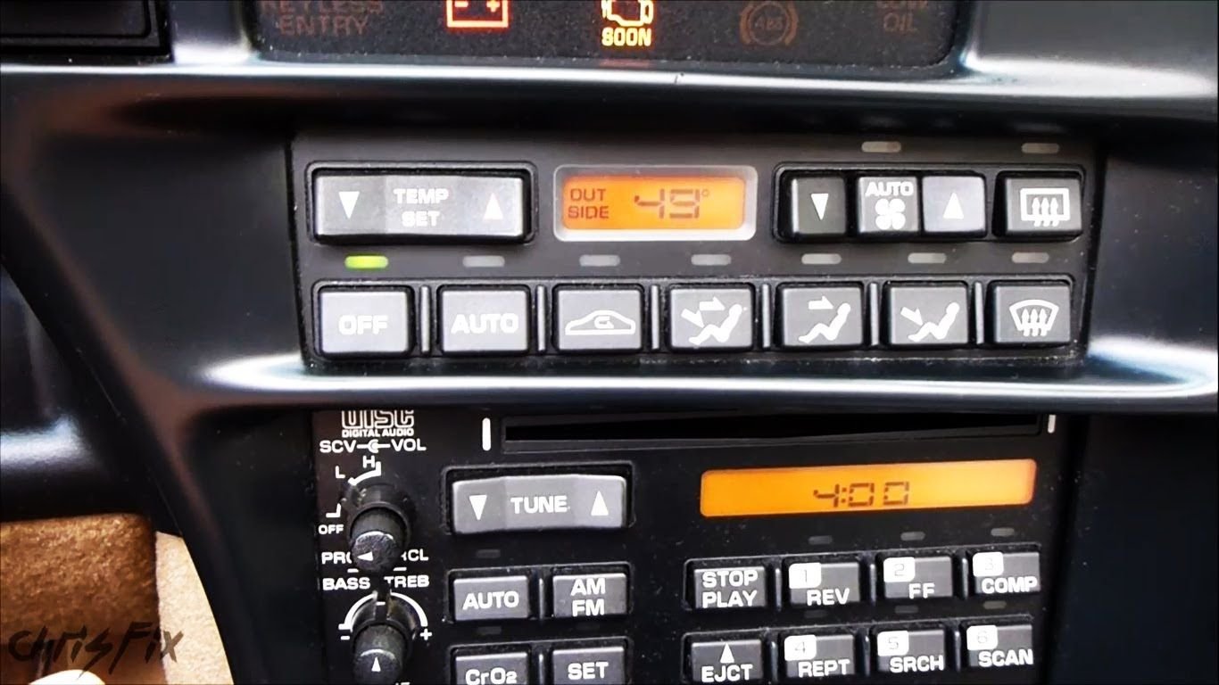

Trying to figure out if I can remove the control panel above the radio and just have a toggle or **** to control the blower motor fan. a/c removed, heater core disconnected.

Not really because car has C68 (auto climate control)vs C60(manual a/c) It can be done you will need to rewire blower similar to a C60 system if you want multiple speeds.
