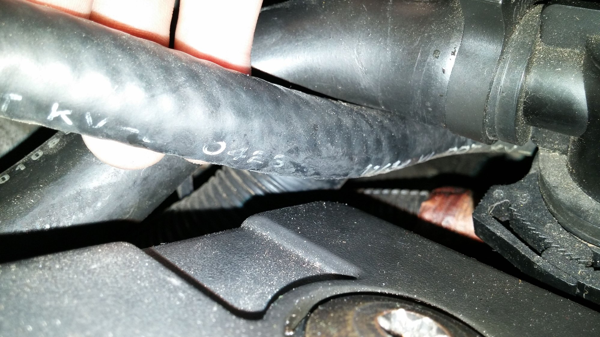

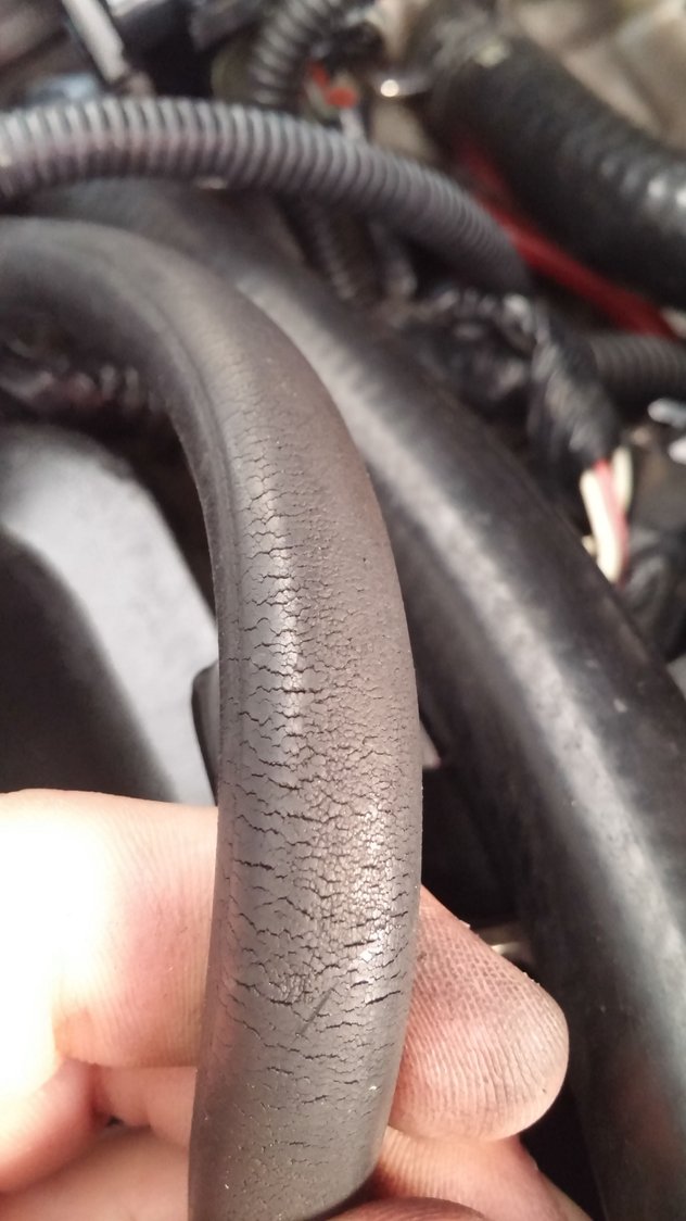

93rubie, that is a badass video. Learned a lot from it, thanks Neighbor helped me do another smoke test just for the hell of it. No smoke came out of any vacuum lines. But I found out that my PCV hose is very hard, no cracks tho. And the brake booster line has a small burn. not sure if you can see it in the pic. Then I found this vacuum line that connects to vapor canister purge solenoid. Should I change them, or keep looking?

That purge hose....I got an idea. Just cap off the inlet to your TB and see what happens.
I remember your trim data being off a bit, if the purge was purging when it is not supposed to.....this can cause the trim to be off. Just a thought.
I also wonder if there is enough air getting around your throttle plates to keep it idling correctly without the IAC. You might want to confirm the IAC is shut like the SCAN tool says it is. Who says it is working 100% correctly? I wouldn't take anything for granted at this point.
YES, Scanner Danner's video are EXCELLENT. A lot of people here would do good to watch them and learn.
Water is an excellent way to find vacuum leaks, you might want to just spray that stuff around and see what happens.
