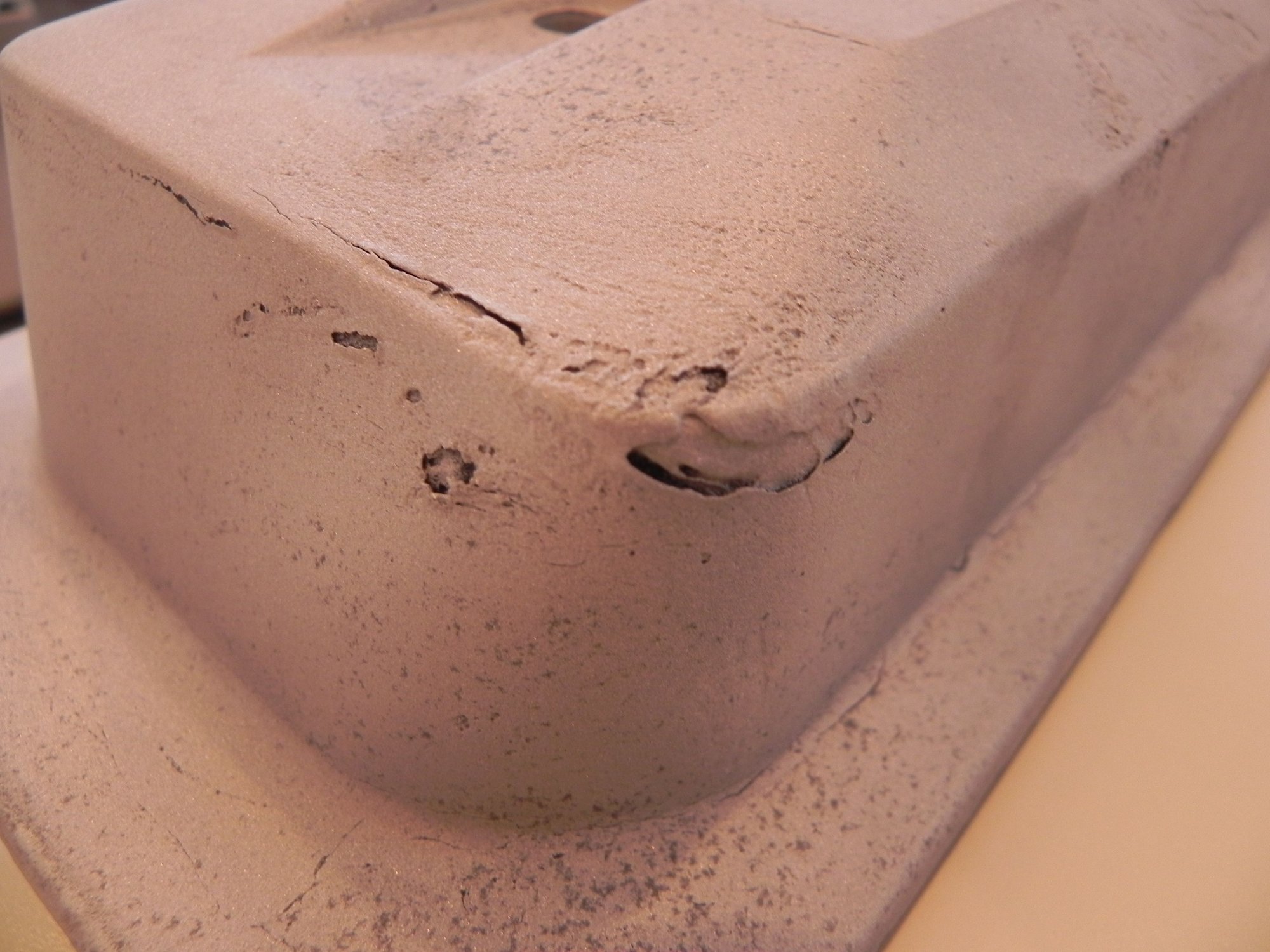

I gave up my quest... have to move forward. The PCV holes are wrong on both sides. The OEM PCV hoses cannot be installed. You would have to do some kind of Rube Goldberg with the hoses. That's just not my cup of tea. I ground down the cancer on the ones I have and I'm trying to come up with a good way to hi temp paint magnesium. I'm going to try VHT Hi Temp (550) primer and then VHT Hi Temp Silver or clear. I don't trust the Duplicolor etching primer due to the hi temps. I don't really trust the VHT Hi Temp Primer either, but beggars can't be choosers. Before:
I may have to JB Weld the bottom to get the gasket to seal.
