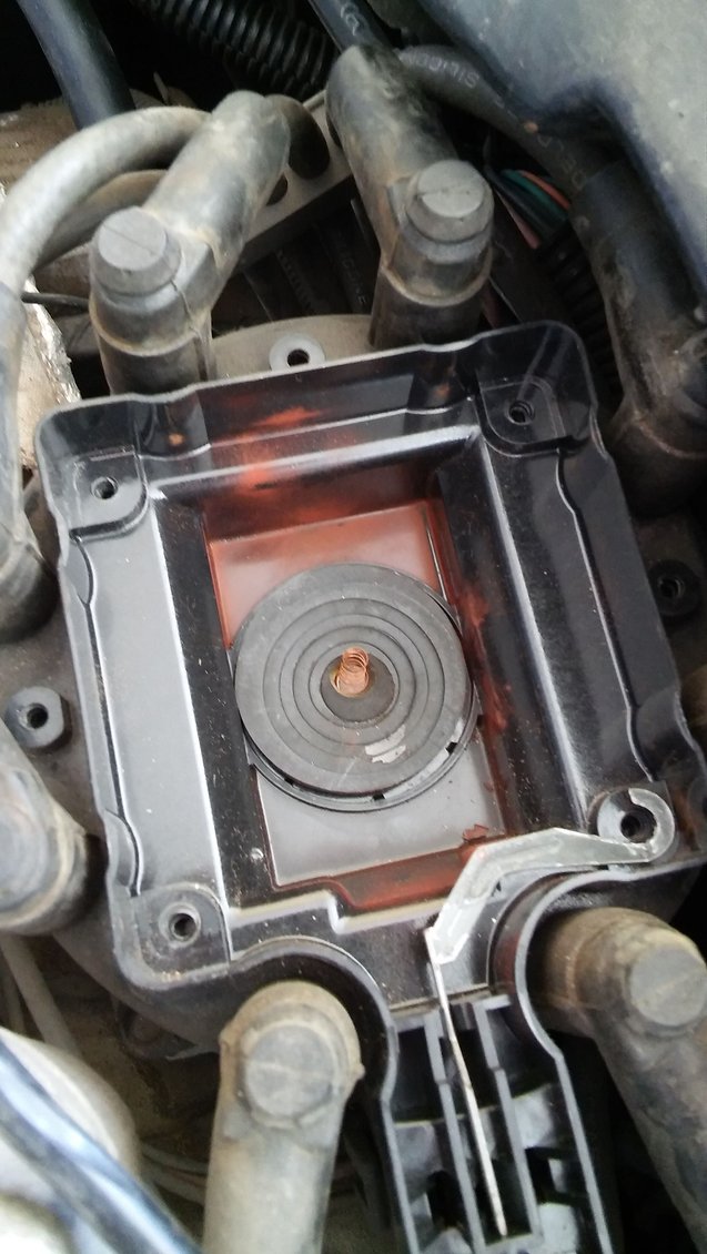

Replaced ignition coil thought that was it but NO (look at pic I have never seen orange dust before)

Under the ignition coil
