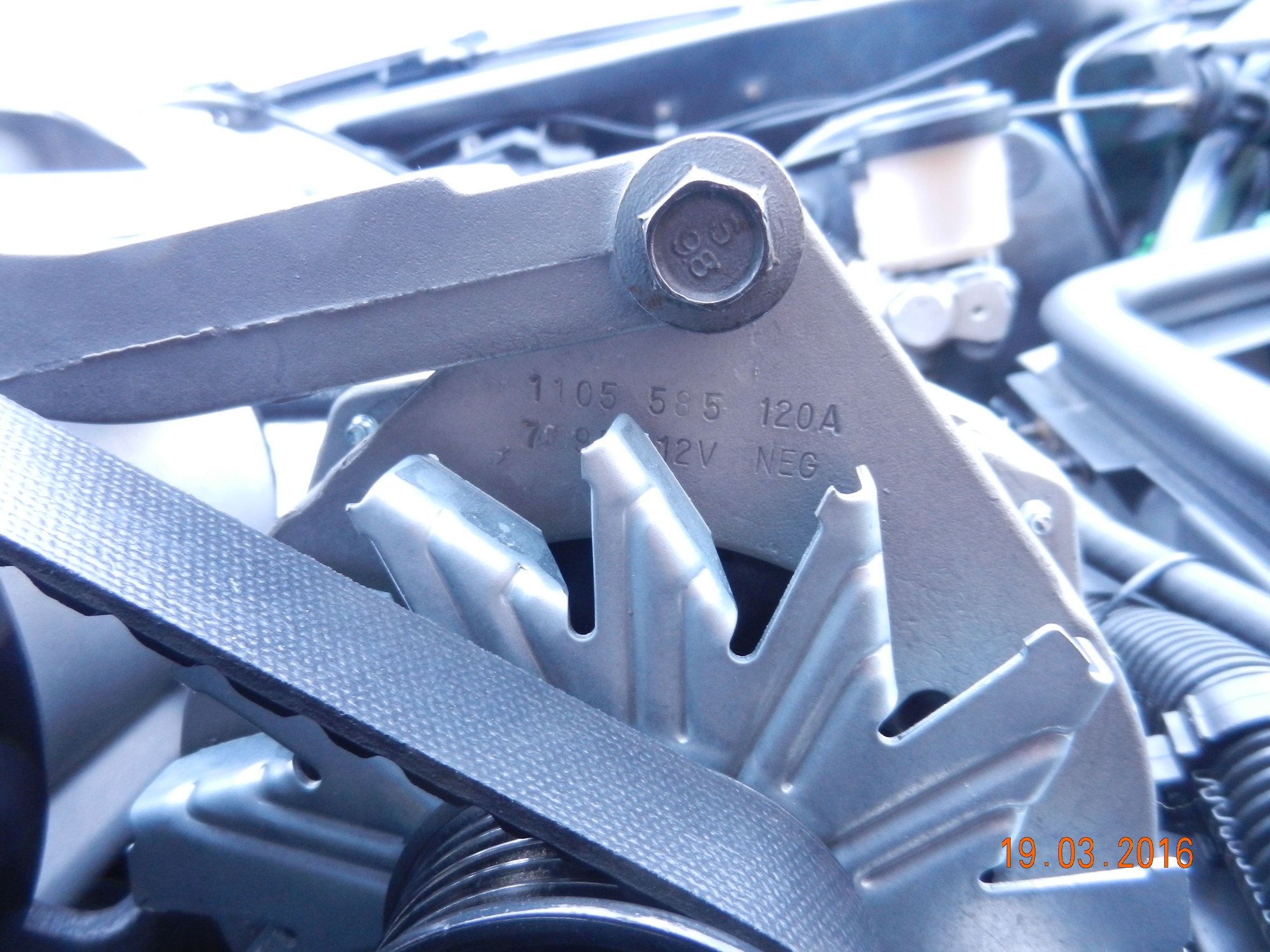

on the front, top mounting ear of the alternator, you'll see a series of numbers - what are they?
(BTW, these are my 85's original) you'll see, as WVZR-1 says, the part number - either 1105513 (97A) or 1101306 (108A), a date code (in my case 7/9/85, although a bit hard to see in the pic), and the current output. if you still have the original, i'd consider rebuilding the original.

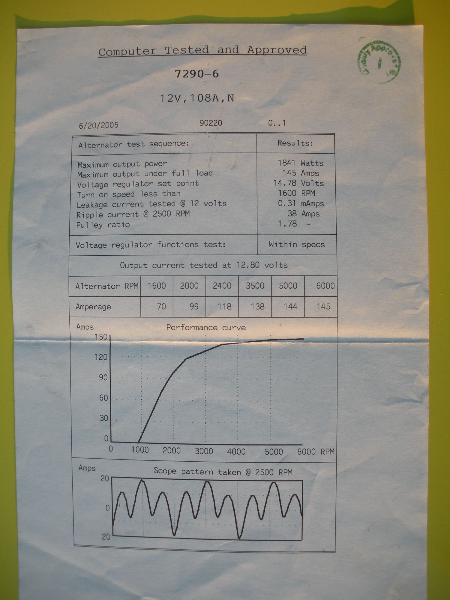

If you decide to rebuild yours, a good shop should be able to give you a good test report on the performance of the unit. Here's the report on my rebuild:
This alternator, rated for 108A, put out 145A max! Note the date: 6-20-05. Working just fine!
