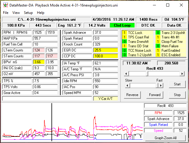

Update; I installed new injectors, plugs and wires. The plugs and wires were as much fun as advertised... I also readjusted the ASR per the FSM. I went out for a drive and took this scan:
As for the original issue of the idle being high at intermittent times it still exists. I do know when the idle is high the air is passing through the IAC passage despite a count of 0. I may just go ahead and replace the IAC ( again ) and check the wiring. It occurred very seldom so I'll get back to it when it bugs me again. If you fellas have any suggestions on a replacement IAC let me know. The first one I put it was an AC Delco from the dealer... Thanks guys.

Unless I am missing something, it says your TPS is 0.86V which means you are depressing the pedal some? At which time, your IAC count is 90. So what is your count when it is at stable operating temp with everything else off but the motor? Should be around 20-30

Started scan before I left for short ride, IAC counts at 21 normal warm idle 650. When I returned and parked, the idle was still normal 575 or so. IAC counts at 0. Didn't have any problems on 10 minute drive. Its a strange one. May also try a different scan program next time to compare.

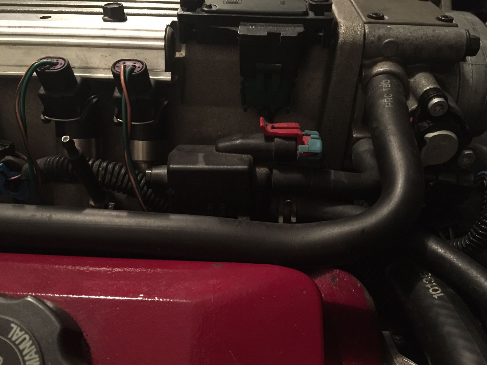

Interesting development tonight... I got a new pigtail connector for my IAC since the clip was broken on the original. I wired in the a new connector in anticipation of a new IAC valve arriving tomorrow. Just to make sure a bad replacement part isn't causing my grief. I disconnected the purge solenoid lines to do the wiring and noticed a bunch of small black "pebbles" in the line coming from the line that comes from below the firewall. So.... I knocked as much as I could out of the line and then blew into the top of the solenoid to clear the build up I could see in the connector on the bottom. Air passed through.
So as I was finishing I was thinking about this. The valve was open. I didn't know what the solenoid did until I got out the FSM. If I understand it correctly the valve should be closed and is opened as needed.
So my thinking is this. Could the purge solenoid being stuck open and partially blocked with the black media, (charcoal? not sure what it is) be part of my Idle issue? And is this an obvious sign that I should replace the purge solenoid? HELP!! Would this even cause a high idle, or cause poor idle. Any help would be awesome!!! Thanks as always. The car really runs good 90% of the time. I just want to get this figured out.

This is the solenoid that had the contamination

There's a fairly easy check of the purge solenoid in the FSM, chart C-3, page 6E-C3-6. ( I think the 92-93 systems are close).
The charcoal might be a failure of the canister, not sure how to check it?
