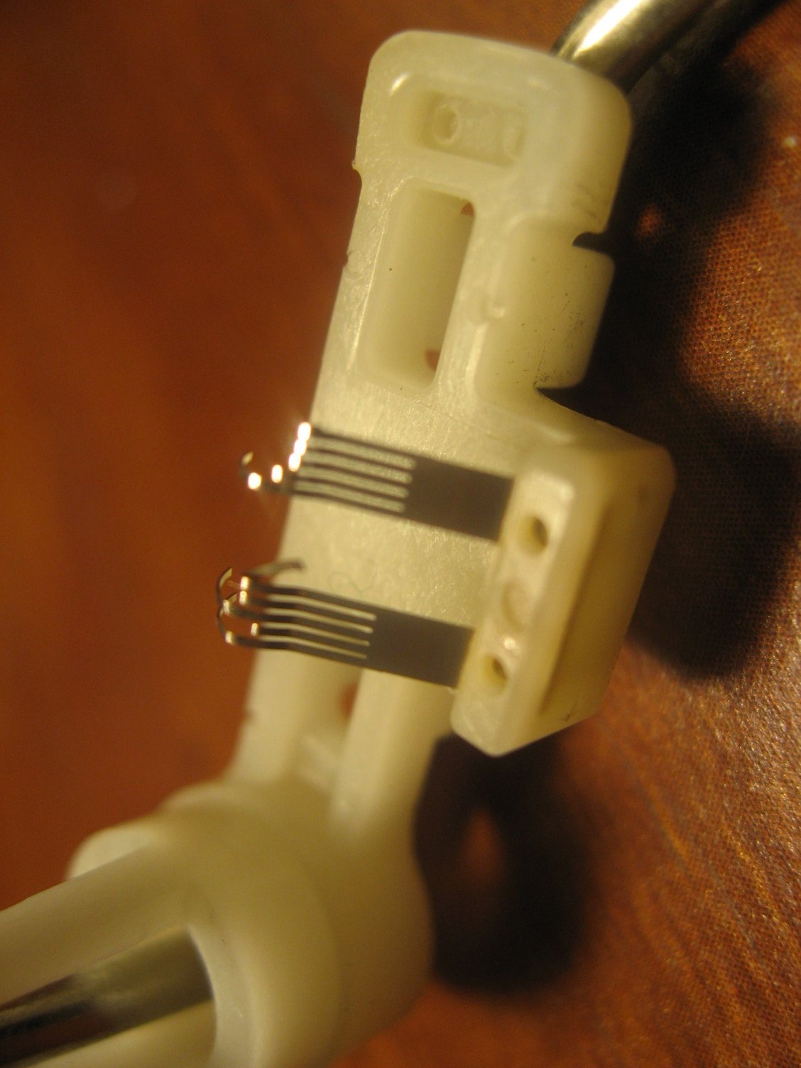

Old Oct 26, 2019 | 01:02 PM
CSixDude's Avatar
CSixDude
Joined: Mar 2010
Posts: 1,901
Likes: 361
From: TX
Here are some photos of the sending unit wiper arms. This shows why adding Techron won't fix it.
