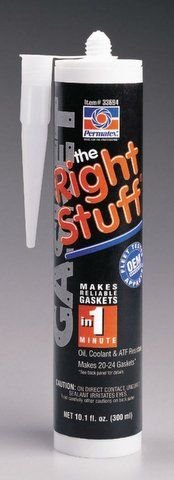

I have used Permatex "The Right Stuff" the last three times I've installed my intake. It has never leaked a drop.
Interested in how this gets cleaned up ? like if i use this on something do i use isopropyl alcohol or something on getting off the surfaces?

Razor blade, Scotch bright OR similar. wipe off with Acetone OR denatured alcohol.
