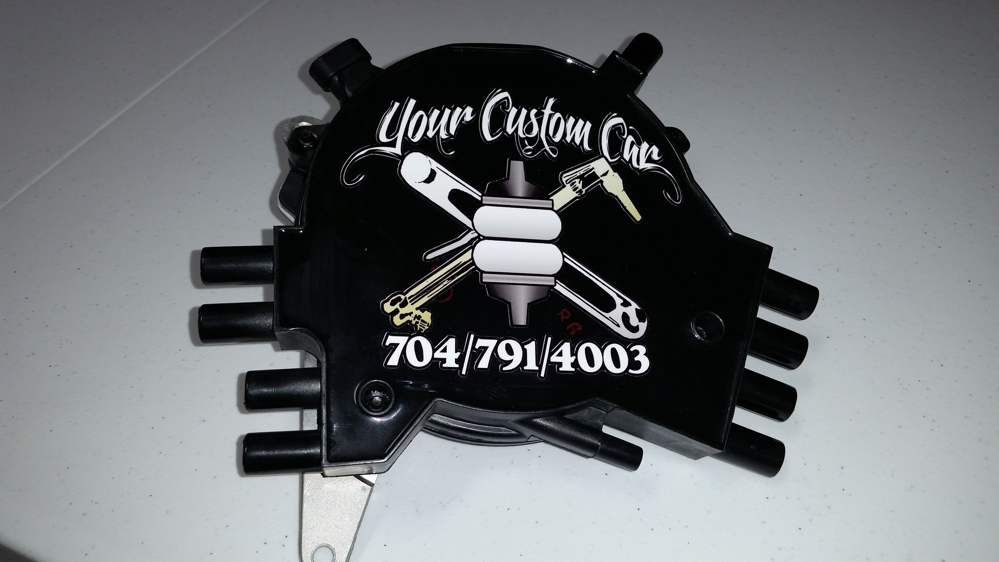

Put my company logo on the Carquest Cap. It will never be seen, but I know its there...lol
