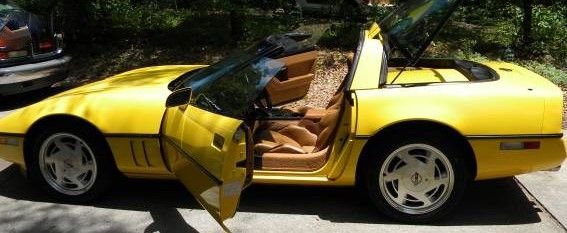

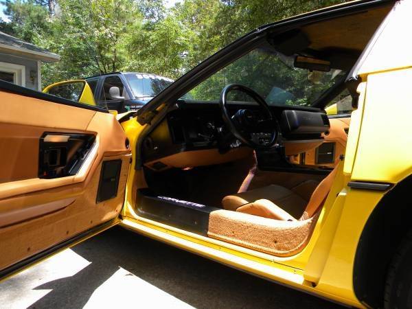

There is a pic of the car as my avatar but here are a few more, mostly from when I bought it, but a couple from when I got it home.

WOW Very nice!

Very nice Big Bird. How old is the paint?
Old Apr 28, 2016 | 08:41 PM
Big Bird 88's Avatar
Big Bird 88
Joined: Apr 2016
Posts: 163
Factory original except for one headlight cover repainted about 15 yrs ago. So 28 yrs.
It belonged to the father in law of the guy I bought it from. He bought it new and it was his toy. Weekend driven, garage kept and babied. Got a very good service history with it.
When he died it had 45000 miles. He left it to the guy I bough it from who put 3 k miles on it and treated it similarly.
Based on the service history, condition of the vehicle and the price, it was a once in a lifetime deal.
Of course my neighbor brought home a Blue 2016 stingray with 9k miles that day !
