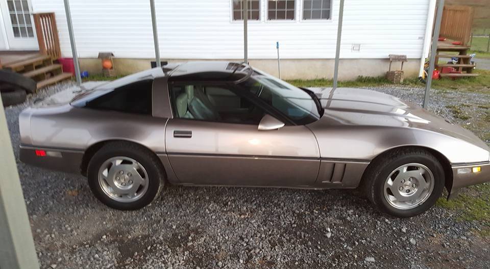

Will stock 2001 C5 wheels fit on a C4 ?
C5 sizes are 17x8.5 front and 18x9.5 rear

Your car is an '88? You're 8 1/2 X 4 now? C5 wagon wheels? If yes to all the fronts 17's will be fine and the rears will fill out the wheel-house a good bit more.

I am also guessing that you have an '88 based on the wheels in your picture.
The C5 wheels will fit the '88 to '96 C4's. All of the C5 wheels have the same sizes and offsets (except for Z06--Those will fit too.) and will fit fine. The C5 rear wheels have a little more offset and will be slightly inboard, but will fit. Some people use an adapter to move them outboard some.
Your 88 base wheels
16"x 8.5"- 50mm
C5 base
17"x 8.5"- 56mm
18"x 9.5"- 65mm
C5 Z06
17"x 9.5"- 54mm
18"x 10.5"- 58mm
These were '99 "wagon wheels" on my '94. I did not use any adapters. The '01-'04 thinspokes have the same sizes and offsets.
These were Z06 replica wheels with the C5 Z06 sizes and offsets on my '96. I did not use any adapters.

The photo in my original post belongs to a friend of mine. I have a set of C5 magnesium wheels for sale and he is thinking about buying them. I didn't know if they would fit or if they would need some type of adapters etc.I wanted to have all that information in my head before he asks.
