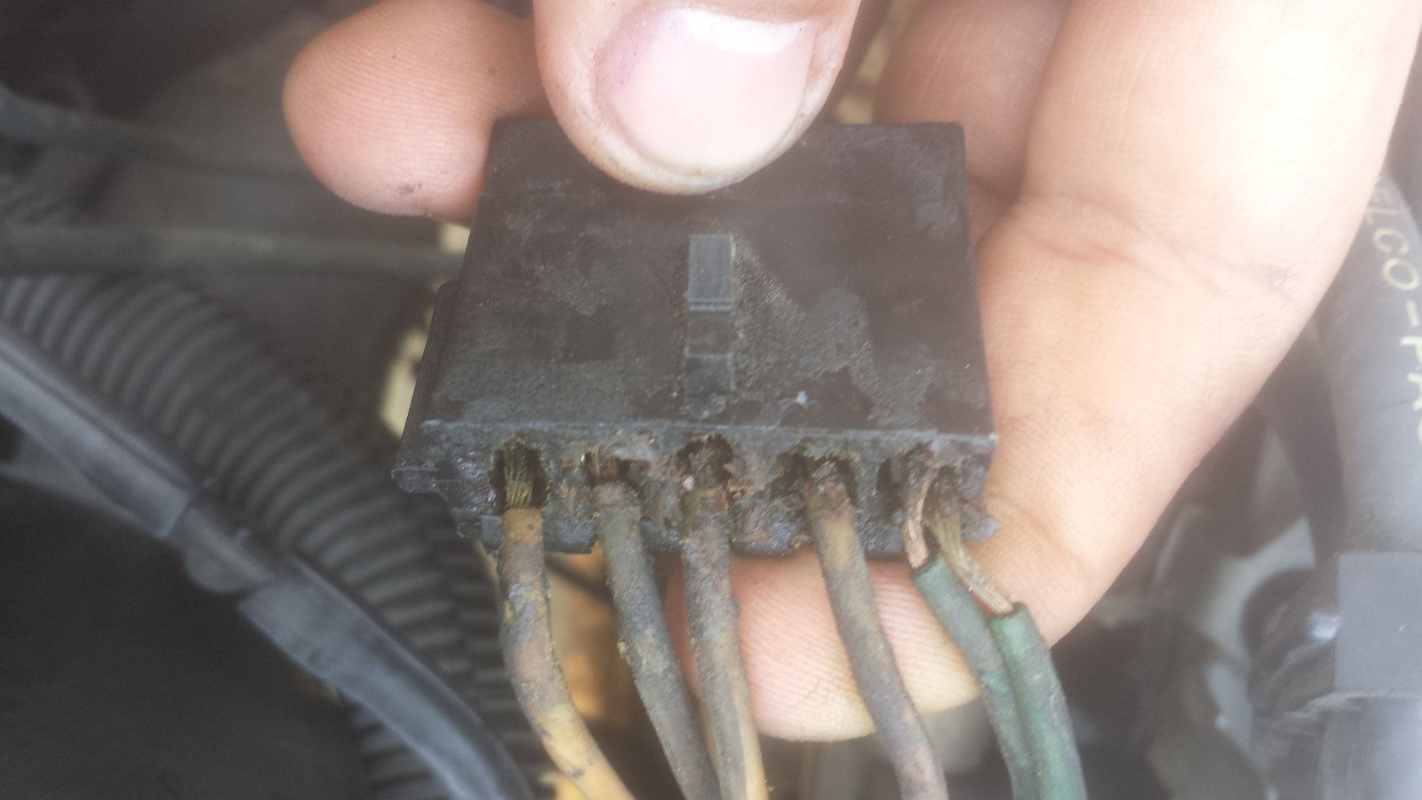

Good afternoon. I am a new corvette owner and new to this forum. I have spent hours on this forum looking for answers to the problem and trying everything I have read. The car is a 1985 with the 4+3 Doug Nash. I start the car and let it get to proper operating temp before moving. When I initially take off it is fine going through the gears and then the overdrive kicks in as it should. However the overdrive never disengages and the light is always on, wont disengage with button on shifter eiter. Now for what I have checked and changed; Overdrive relay on the firewall is new, also checked wiring below relay plug which looks good except possibly where wires go into plug (will post picture) overdrive switch on shifter is good along with wires to the plug, fluid is at the bottom of the filler hole as forums state, and it has had regular service as I have the records from the previous owner dating back to 1996. With everything ive read iv almost come to the conclusion that the unit is good otherwise it wouldn't go into overdrive at all? Shifts fine through all the gears forward and reverse works as it should. Would a bad solenoid possibly cause this? Also read that possibly a bad TPS could cause overdrive yo kick on all the time? (I have one on order i think its bad fue to eratic idle up and down at running temp) Im open to hear suggestions and input on where to go next.

I would not suspect the TPS. At full throttle the ECM should command a kick-down & deactivate the O/D, but other than that, the TPS has no say in when the O/D is activated...wouldn't ever fail in a manner which forces full time engagement.
A stuck or shorted solenoid could potentially be at fault, but the best approach would be following the FSM diagnostic tree & do some diagram-aided wire tracing. I don't have one for '85, but I'm sure '84 is very similar; if nobody is able to post pics of that section from your year soon, I will put some from my manual tomorrow.
