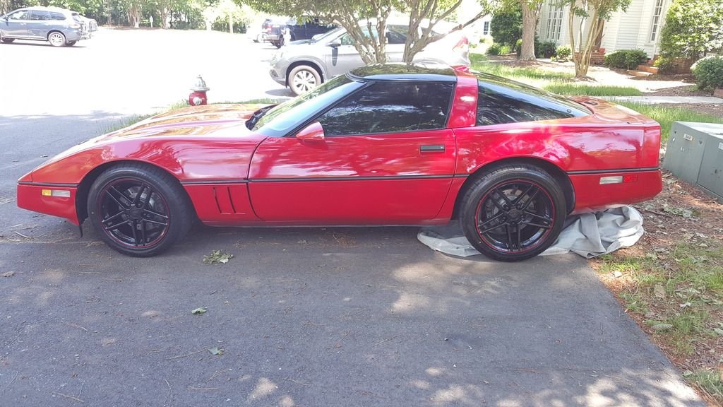

Hi all, just installed new wheels, 17/18 staggered setup and would really like to drop my rear a little. After searching here on the forum I found someone that used 11.2" M14 Grade 10.9 bolts from Fastenal and I wanted to see what other size bolts work as well for a 1-1.5" drop. Also, do I necessarily need to drop the front....heard it's a pain. Thanks for all your help!

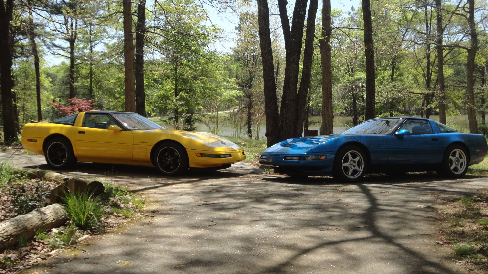

Great advice in the post above. You do not have to lower the front. Here it my 91 & 93 the yellow 93 is stock the Blue 91 is lowered 1 inch in the rear only.

Nice comp yellow vette, I have same in 92 flavor. Are those 17" squared? The OP is going with 18's in back I believe. 1" drop rear will still work.

Nice 92, they all GM A-Molds ZR-1 offset.
