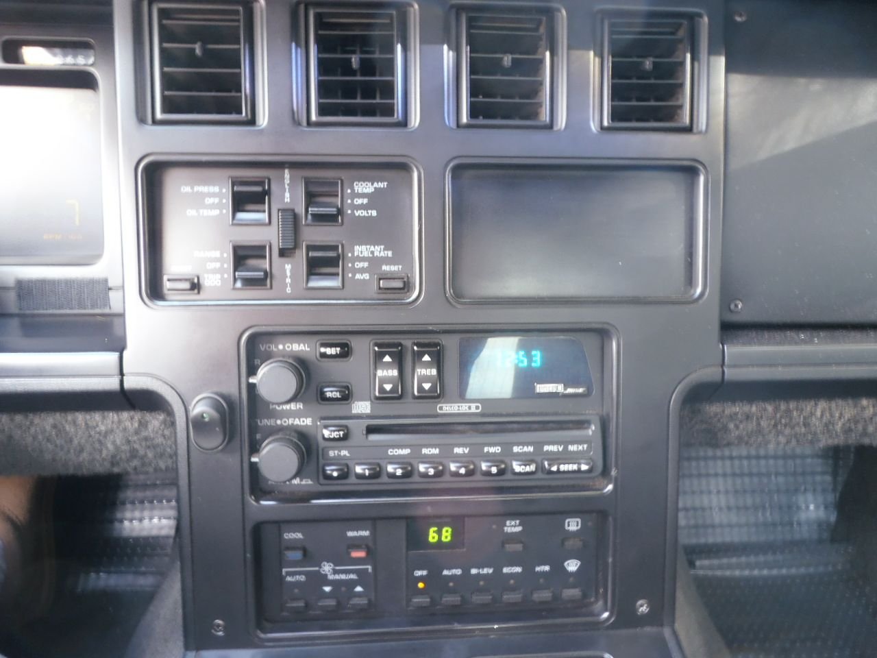

What I did was install a antenna power switch next to the radio.
This prevent s the antenna from being used when your using the tape/disc player.
Saves the wear and tear on the antenna.
Simply splice the switch in the pink wire behind the radio.
Old May 15, 2016 | 12:59 AM
mako41's Avatar
mako41
Joined: Sep 2008
Posts: 694
Likes: 27
From: St James New York
Hey is that a Bose Radio w/CD out of a Camaro??
