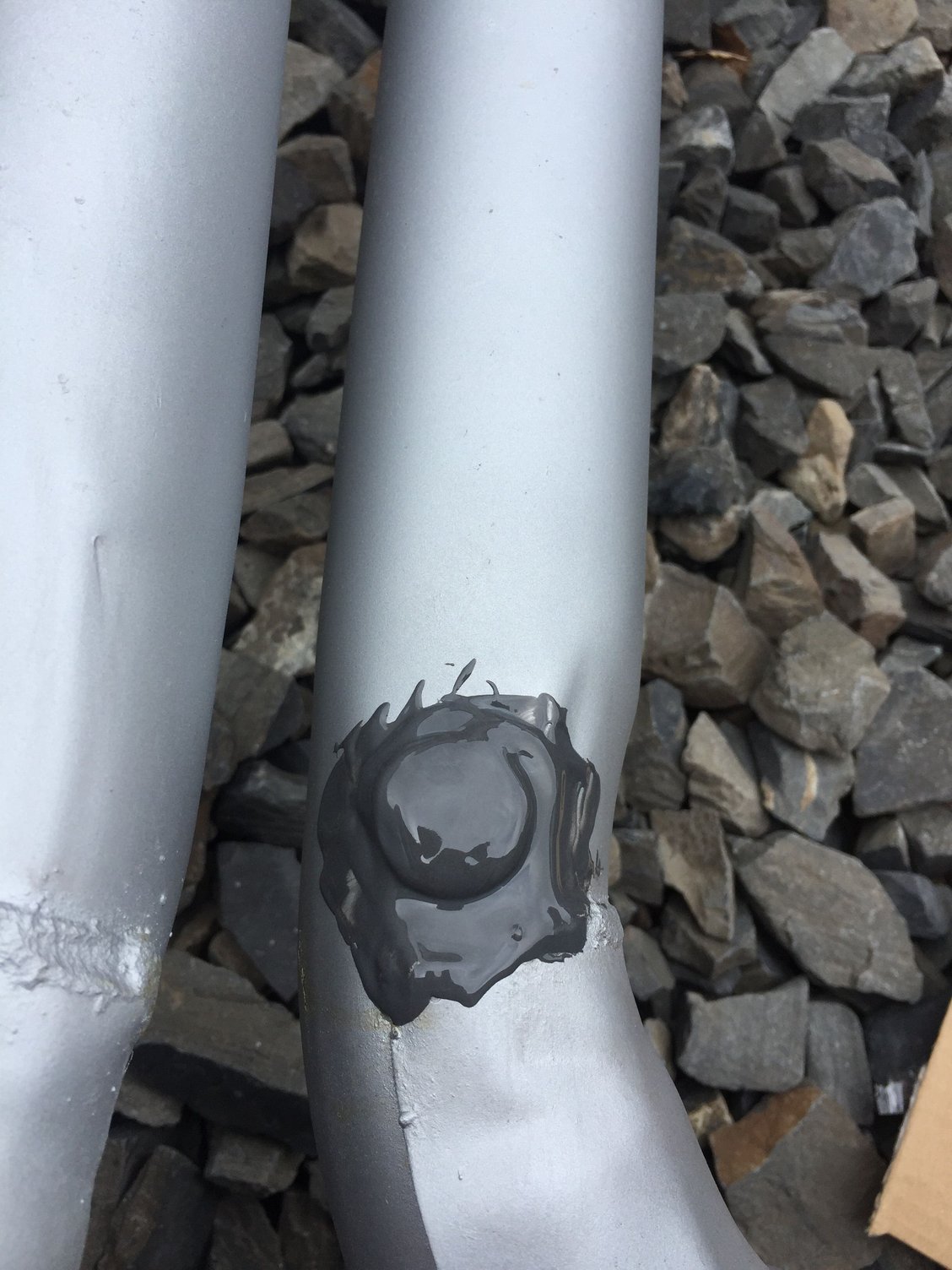

if you are under the car for any of this please please have multiple jack stands and blocks and redundancies.
i had a hole in the rear y pipe. this is what i did after sanding and grinding the hole back to fresh steel.
coated with jbweld, placed steel washer over hole, coated washer.
let sit for 24hrs. or u risk the exhaust pressure blowing through the jbweld. dont use the quickset.
been fine for a long time.
