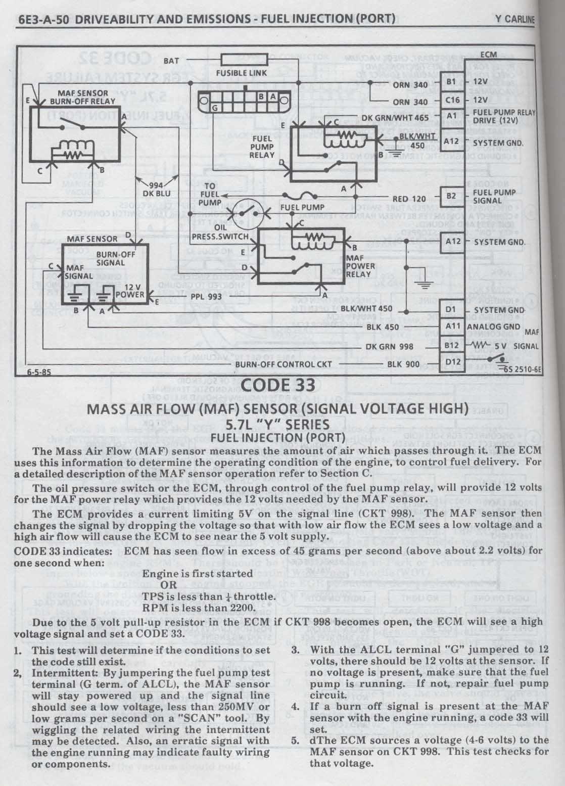

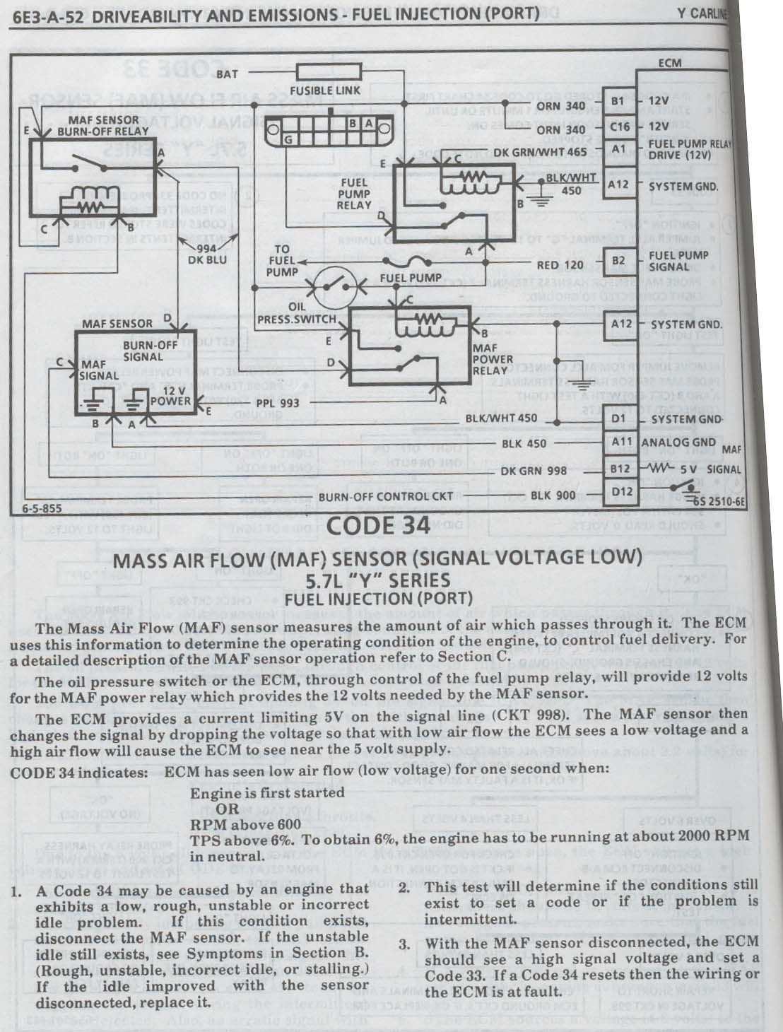

This help?

Originally Posted by antfarmer2
This help?
What is this fellow with an '84 TBI "cross-fire" supposed to do with these later TPI charts.
OP - HRR mentioned both 33 & 34 are MAP related and that's certainly correct. Did you have MAP codes before you replaced the MAP OR are codes the aftermath of work you've done. It certainly seems that if the codes were there before you started you've possibly many issues. Brand and part # of the MAP you bought?
