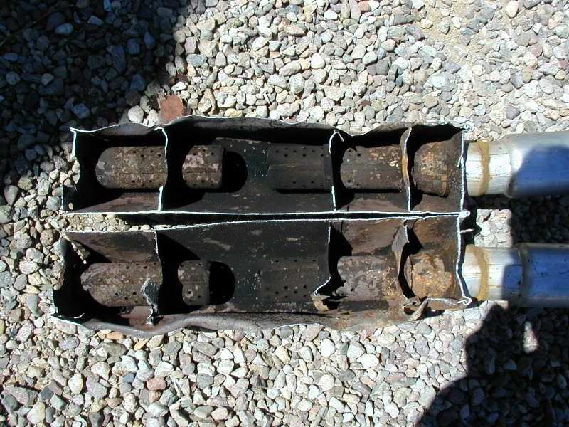

Tom, you're own post (Post #21) from the following thread clearly shows the LT1 pipes merge inside the resonator.
https://www.corvetteforum.com/forums...removal-2.html
In the following image (from Tom's post), the resonator is cut open and turned out 180°...
Yep, you're right. I forgot about that pic/thread. IDK what good the thing does w/regard to the topic at hand though; the cats are upstream of the resonator and would act as your "termination box". My guess is that the stock exhaust is so far from "tuned" that none of it matters...which is why I stated in my first post that most put in x pipes for sound or because "other people do it". On a stock exhaust, I doubt that it does much of anything.
