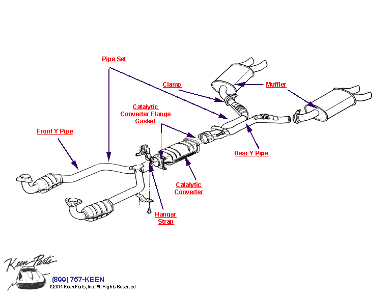

I am replacing complete exhaust system. There is a hanger that attaches to the clamp attached in the area of the cat, that holds it up, but for the life of me I can't find where it connects to underside of car. I am not talking about the long rubber hanger that hold up the rear y pipe

the hanger strap that's in the front of the main cat bolts to the bottom LH side of the transmission -

Thanks, never looked there
