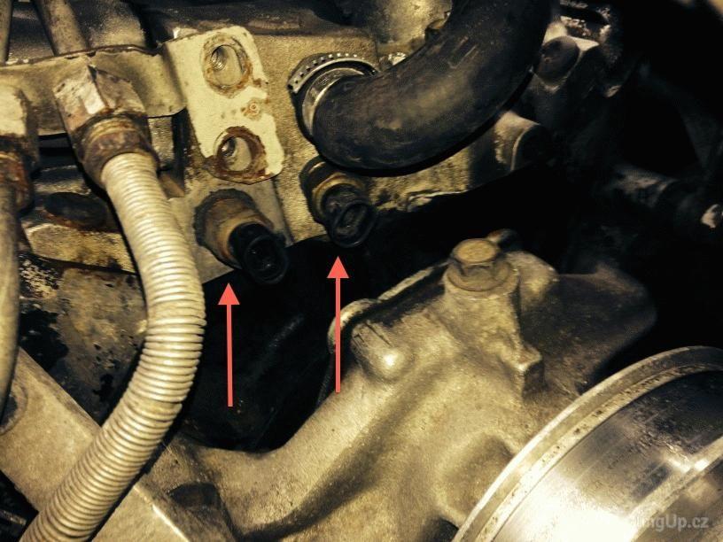

Default intake manifold sensors
ok new question. My 85 has two sensors on the front of the intake manifold. I know which one is the coolant temp sensor but what is the one next to it? thanks
sensor on the left provides the signal for the cold start injector, right sensor, coolant temp sensor - signal to the ECM. coolant hose connect to the throttle body.
