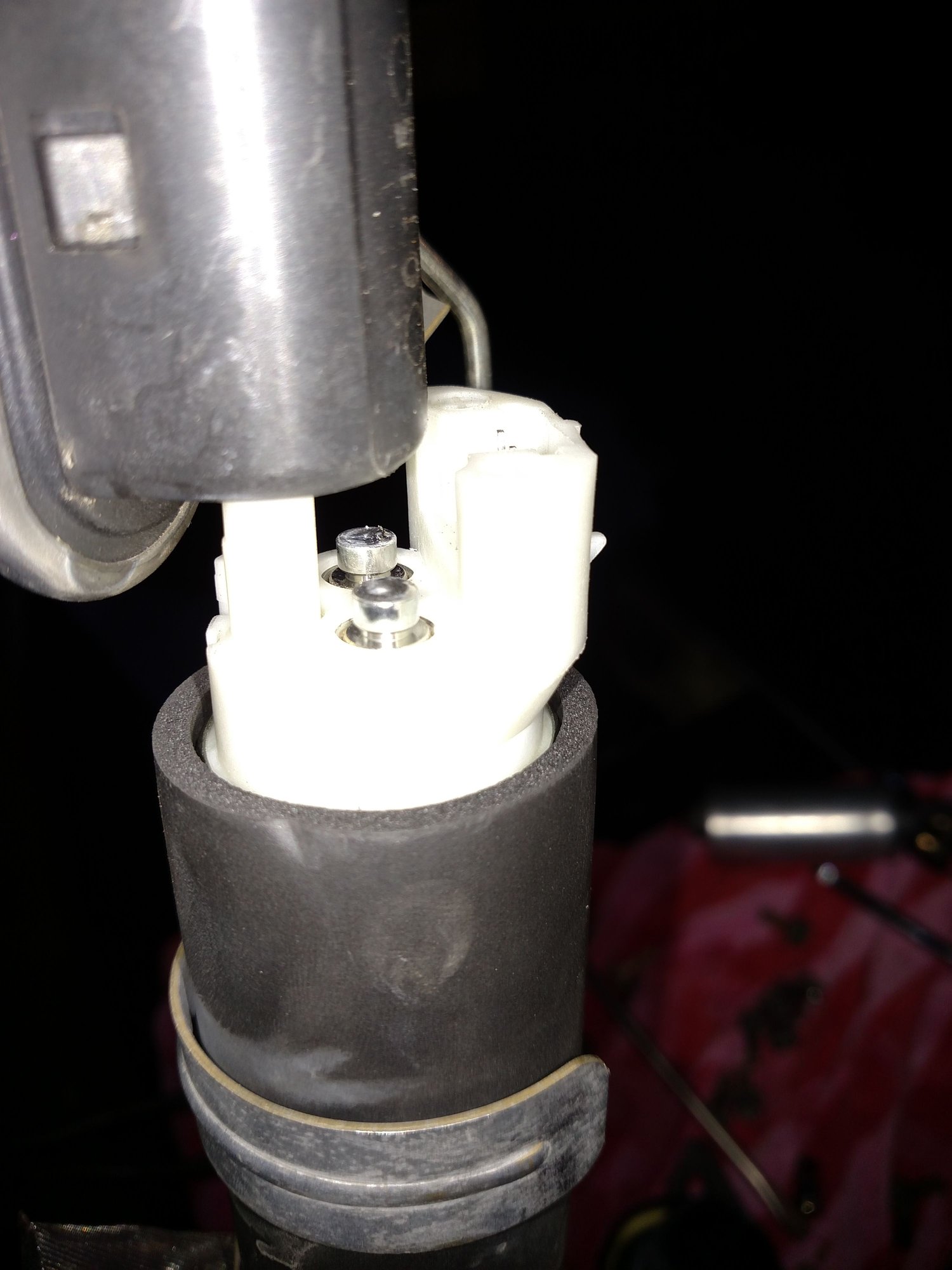

Here's photos with captions of what's what so you guys can see exactly what I'm working with
Heres the pump i pulled
Top side view of the new pump mounted
Top down view of new pump with yhe + and -
Top down view
Those are the two wires that were connected to the top of the old pump
Then theres that red wire that i didnt touch

Oh to add onto that must have recently blown because ot wasn't that the original fuel pump was dead completely its out was just very weak when I tested the fp at the rail
So I made sure to swap the fuse and noticed what could have caused it is that the new set up of connectors are too close therefore the + and - make contact to separated the two with electrical tape and gave it a shot and it started up fill pressure so far so good. Thanks for all the advice and insight CF these threads are always so helpful and thought provoking.
