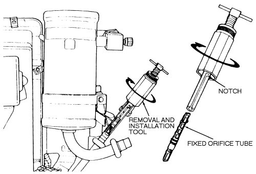

This should help:

- BTW, there is a "special" tool to R&R the orifice tube itself. it can be done without the tool, but there is a chance of damaging the orifice tube itself. bought mine at summit racing for about $7.
Originally Posted by Cliff Harris
This should help:
PERFECT!
