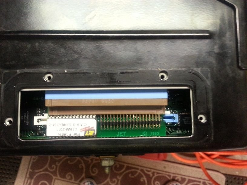

Here's what's inside the ECM :

Looks like a someone had a custom tune done.

Here what you have.
http://www.moates.net/g1-memory-adap...-etc-p-32.html

Originally Posted by kenpeindl
Then the OEM chip was just placed loose inside the housing. Seems like it could cause a few issues bouncing around in there!

I didn't think the PROM should have been loose in there. I thought it actually plugged onto the board and was the "limp home" etc. I believe the PROM just became detached from the MOATES device.
I thought so. Here are a few picks of a Jet performance chip that someone gave me with the memcal chip attached. What got me was it still started and ran without the memcal chip.

I believe I got the problem solved. I removed the Moates adapter and plugged the OEM chip back in by itself. SES light did not come on, car runs great again, no rich exhaust smell, no stumbling on acceleration. NO codes set.
Sooooooo, the OEM chip plugged into the Moates adapter? I believe I got a LOT to learn !!!

NO one noticed?? with the specific MOATES adapter that was installed in your 90 - 93 ECM
was in fact designed to MOD a 89 and below Prom carrier. TAKE note inside of your 91 prom carrier. there is actually a daughterboard that contains your KNOCK sensor. WHO ever did this MOD was clueless. your knock senor was OUT of service. post 11 has the proper adapter that should have been used!
