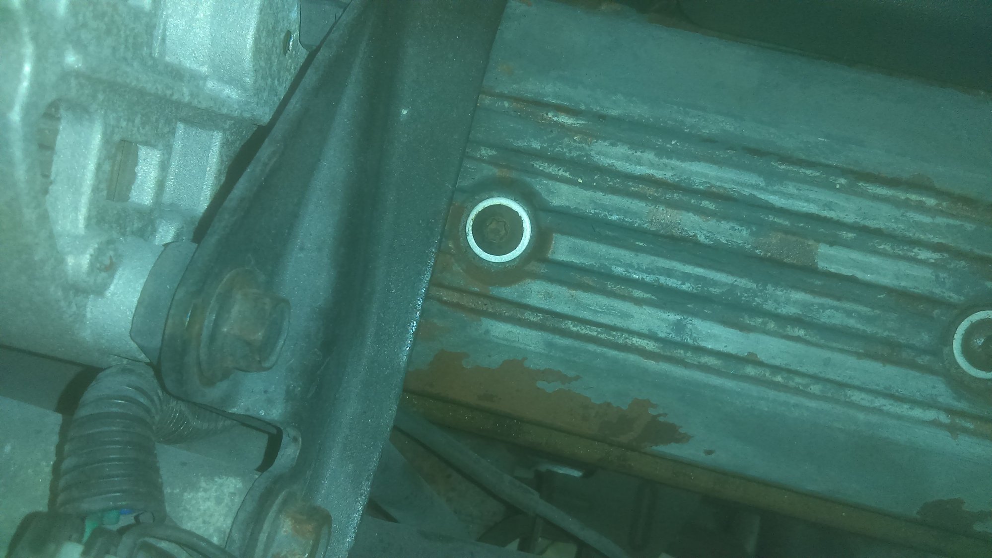

Been doing some engine detailing on my 92, the valve covers look like a gold color, does anyone know the correct color?

Yikes!!
Pewter/silver would be better.

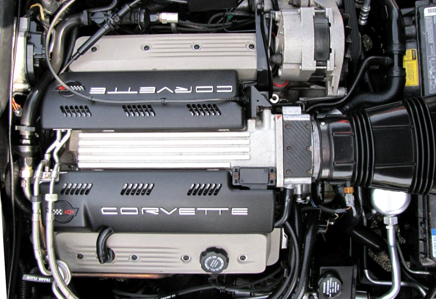

Here are shots of my 1992 valve covers:
Definitely not gold.

on the l98's at least i think they called it "magnesium". which for me anyway, is confusing because im not sure if they were made with magnesium metal, then painted with a "magnesium" colured paint. or made with some pot metal alloy then painted with magnesium coloured paint!

The valve covers are indeed made of magnesium.
