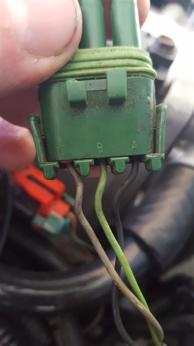

Gary-Thanks for the input. I went back and reinspected the MAP sensor and noticed the clip on the connector is broken off. Seems to still be holding fine but I want to repair this to rule anything out before continuing further. I unhooked the battery for 30 minutes and then drove the car for 2 hours on Sunday afternoon and the SYS light never came back on.

Problem Solved. Fixed the connector. I have driven it 300+ miles and no more light or code stored.

Oh hell yea! My connector looks like the one in your last pic, but I won't fix it till messes up.

Absolutely I try to do that as much as possible. I also referred to this video for re-pinning the connector. Made much more sense than buying a pigtail connector and soldering one in.
