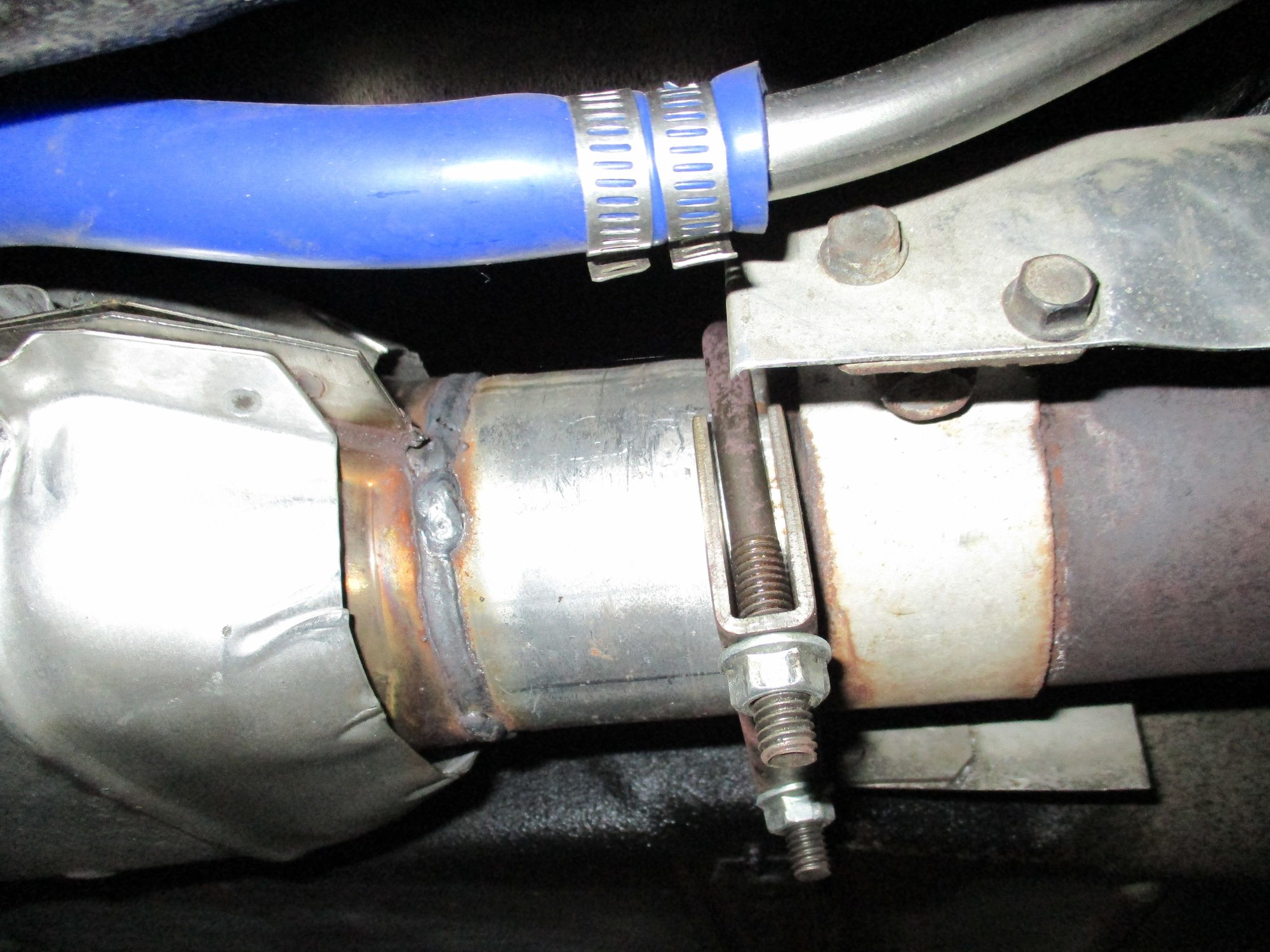

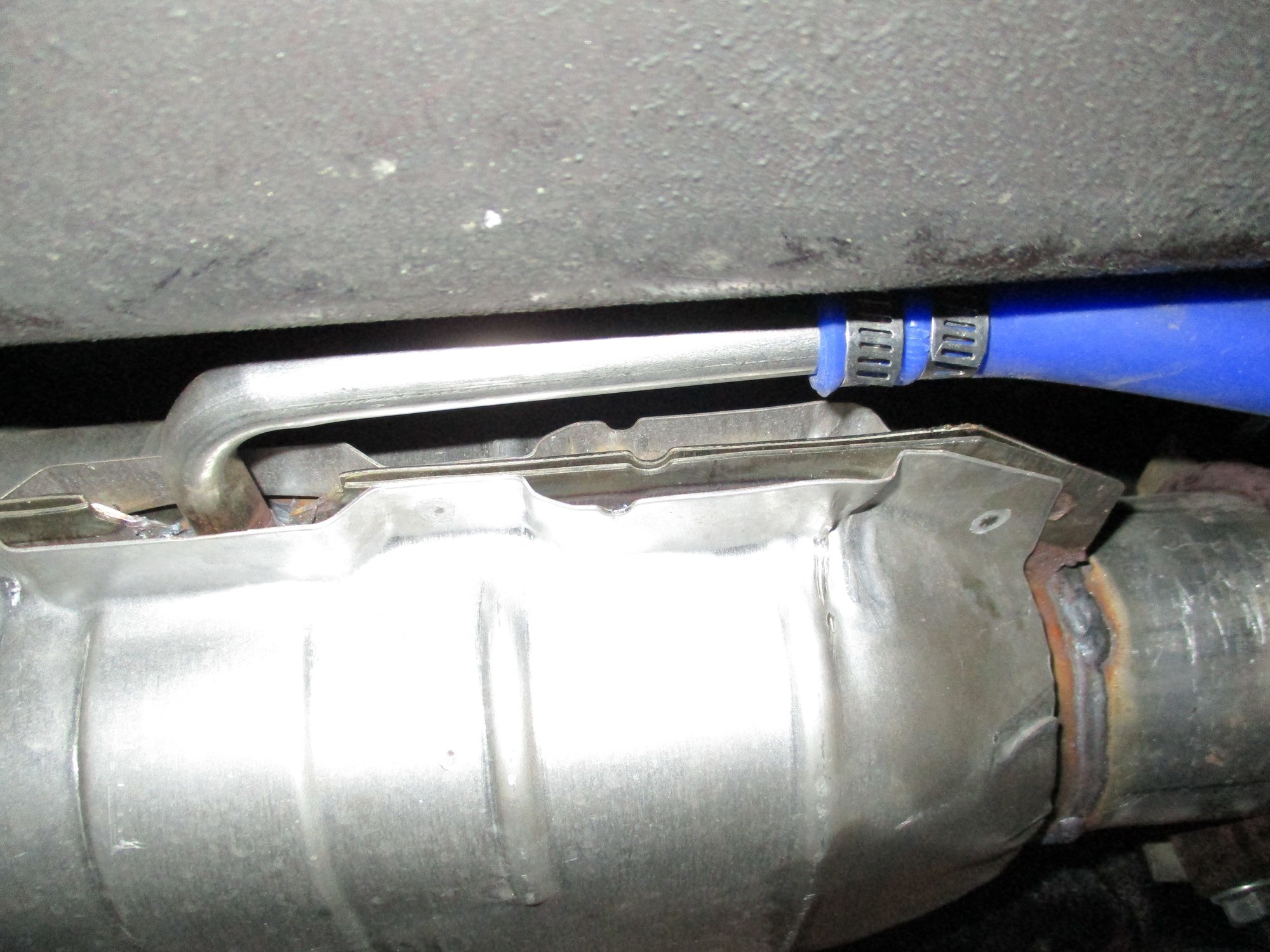

I replaced my main cat and the front Y pipe on my L98 daily driver. Had the same issue you are having. I ended up cutting the small EGR pipe, then when putting the new cat on the car, I used a small section of high-temp silicone hose and a couple hose clamps. Worked fine - have not had any problems, and no issues with the annual state safety inspection I have to go thru either.

Where did you cut it? As close as poss to the cat?

Here you go.

You've cut a small section out of it

Originally Posted by seu318
...used a small section of high-temp silicone hose and a couple hose clamps. Worked fine...
- that's what I used bought a 1 ft of 1/2 inch hose on fleabay for $2.61 shipped. probably cost them more than $2.61 to ship it -
