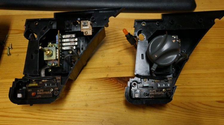

Yeah, that's also why I bought the 96 switch when I thought the 91 was faulty. Here's a pic, left is 96, right 91. Led color was different and ASR added to 96 but would've been easy to change the faceplate.

On the led lights it is just a yellow rubber sock that fits over the bulb. Not sure if that little sock is available to purchase or not as one ripped when I was putting on a new bulb. That bulb is the same as the one in the vanity mirror on sun visors.
